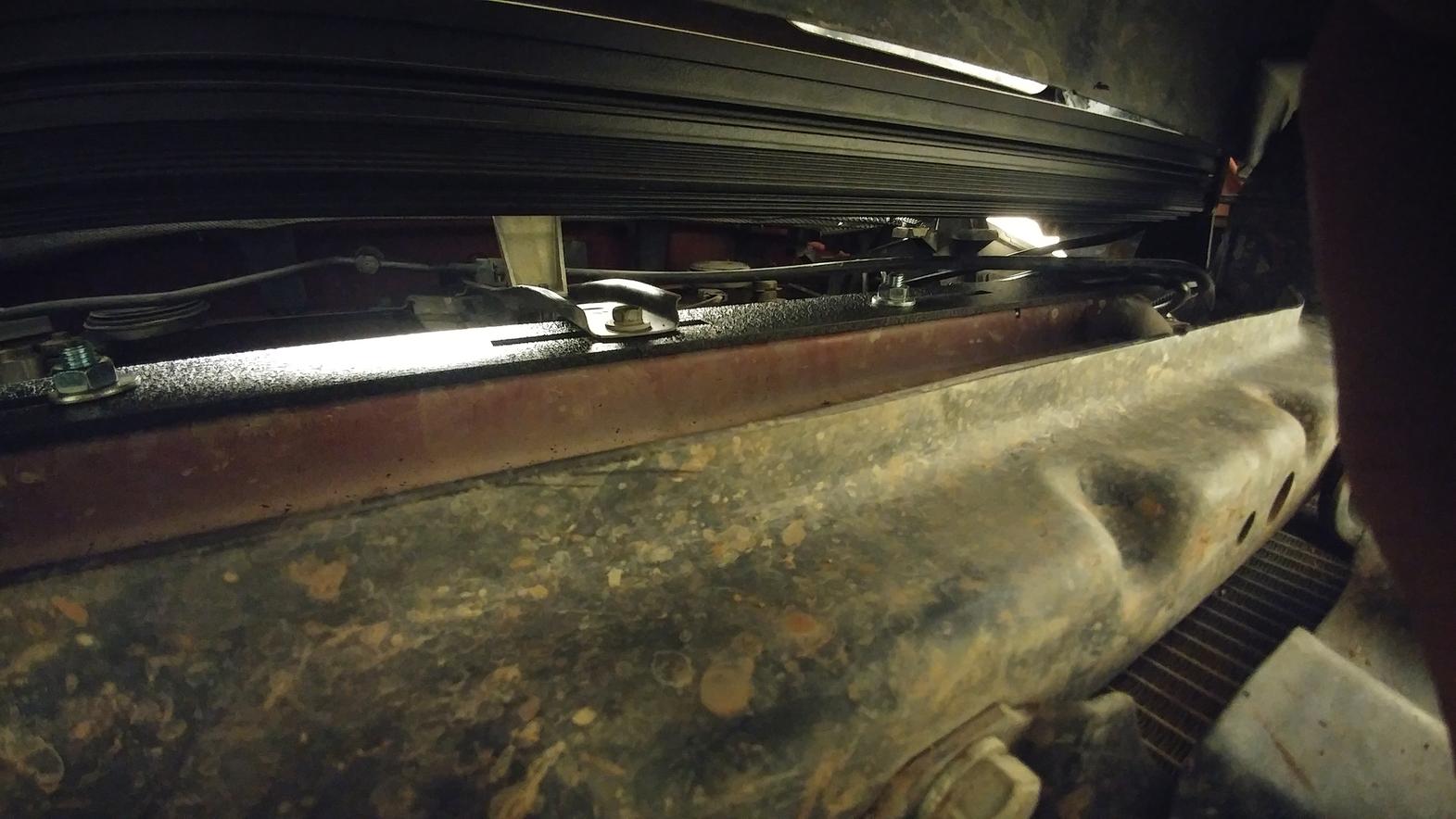

OK, now all you gotta do is go to the hardware store and snag 3 or 4 bolts and nuts, and double that with washers and now you have stuff to mount the bracket to the radiator mount.

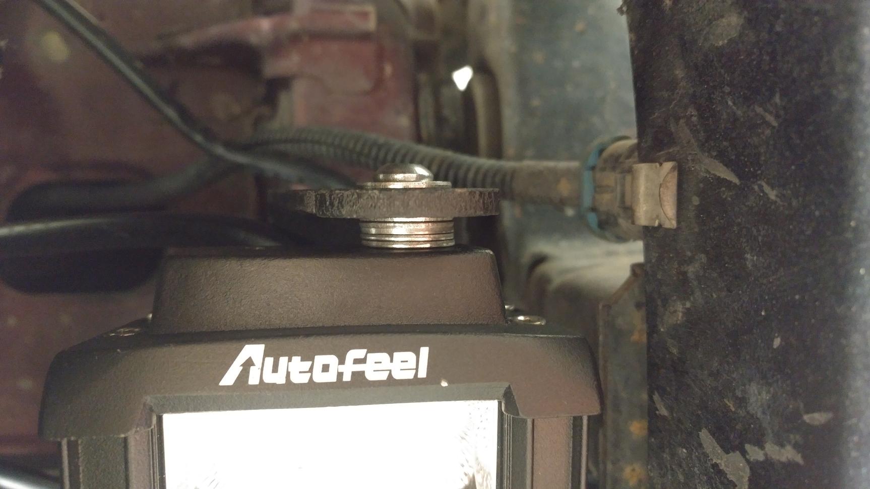

Here you can see that the little mount in the middle easily goes over the light bar bracket, I didn't even have to buy a new bolt. There are no clearance issues or anything with the light bracket.
Now the bar was like an inch too short for my mount so I just shimmed it with washers

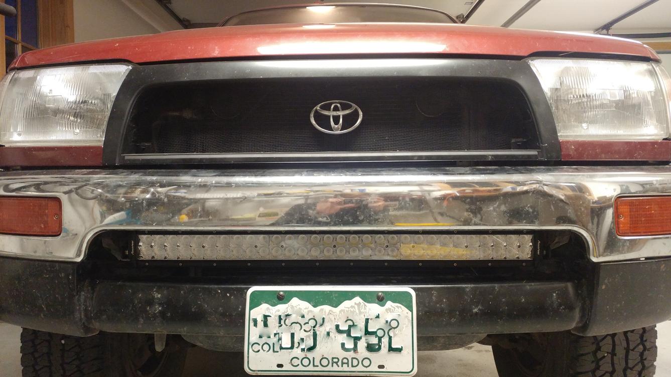

Here is the bar itself. Ignore the dirt and small dent in the bumper lol
Very easy and cost me a total of about 85$ for the bar, bracket, cheap ass Chinese dremel, and relay+switch
