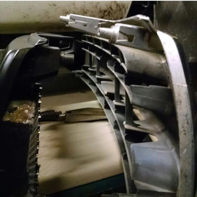

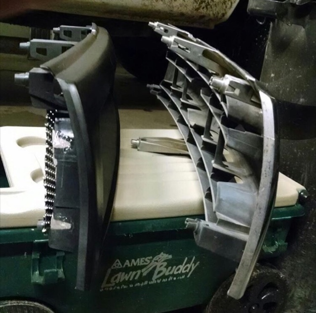

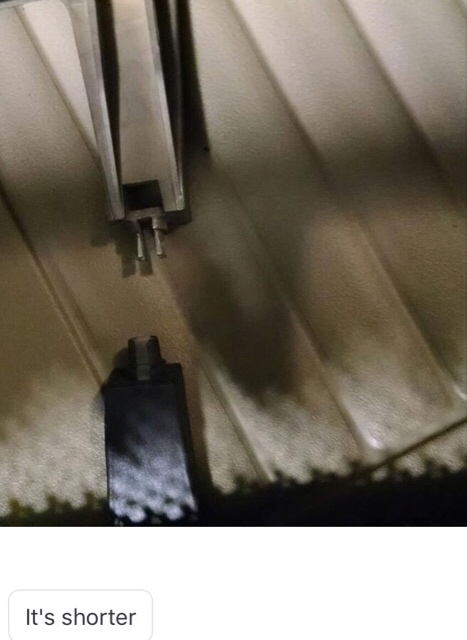

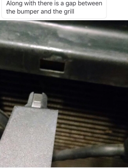

Here are some of the photos he sent me. Does this seem fishy? He said its shorter.

its a direct swap. The aftermarket pegs may need to be trimmed.

Yep, he just needs to trim/shape the pegs on the aftermarket 96 grill.
Not hard and if he had a brain, he would spend the 1 minute to trim them rather than wasting everyones time. good luck
I've built 25+ grilles for people. I always use aftermarket grilled from partsgeek or rockauto. It will fit. I have heard from some people that the tabs need to be trimmed a bit to fit. The grilles have a more round peg that needs to fit into a square hole. Either use a razor blade or dremel to knock some off the peg.

the 01-02 grill sticks out forward more but they are both cross compatible, if it doesnt fit that means his front clip is messed up and thats not your fault. as far as having to modify the clips, thats just a reality of any body panel, it needs to be fitted theg dont always simply bolt up. sometimes they require a bit of persuasion.
