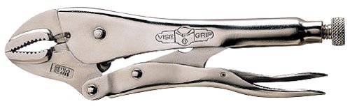

First off, there is no bolt involved (absent PO barbarities). They are studs with nuts, and the studs are much harder than the nuts. So the idea is to crunch/crush/crumble the nut and then clean up the threads on the stud.
These little 5-inch Vise-Grips did the trick for me--small enough to maneuver in there and strong enough to crush the silly nut.
Vise-Grip 09-5WR 5-Inch Vise-Grip Curved Jaw Locking Pliers with Wire Cutter - Tools Products - Amazon.com
I just did my front 02 with rusty nuts. Lol. As said. They are studs with soft nuts. A small pair of needle nose vise grips took mine right off. They are not that tight. Always have a small torch handy. Makes jobs much easier. You might have to clean the threads with a die if messed up.
