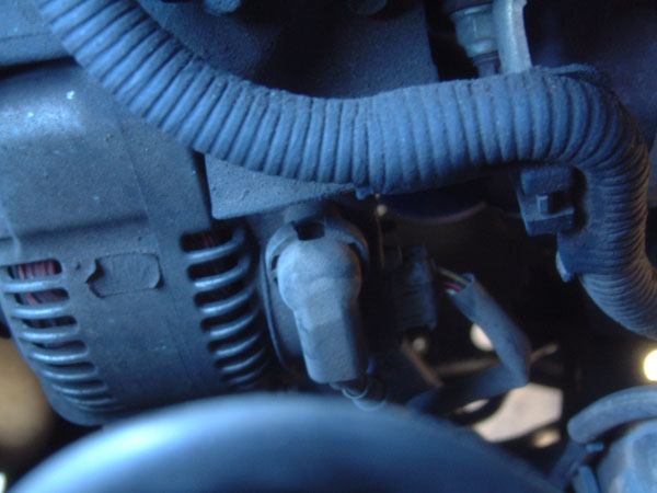

my dad was trying to remove the alternator on the 4runner. The last thing he had to remove was the generator/alternator plug. When we was pulling on it, he pulled on it too hard and only the wires came out. now we don't know which order the plugs go. If somone can easily take a picture of theirs, or know the schematics it would be greatly appreciated.
car: 1996 toyota 4runner sr5 v6
thanks.
here's what it looks like now:
okay, here's a picture of how the plugs is plugged into my alternator. i have a '97 which is very similiar to '96 so hopefully this works. if you can't see the color of the wires in the picture, it start from yellow, red, and white. wonder how the wires got messed up. if you need any other pictures, let me know :D
