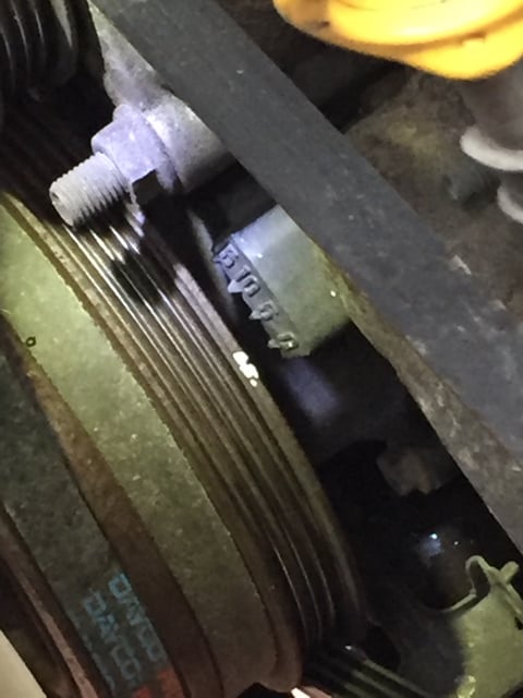

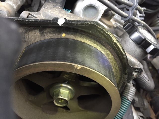

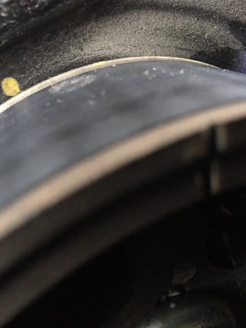

Lined up at 0
Left bank
Right bank. Without cover totally off this was the best I could get, you can see its not aligned
So, how exactly did this happen? Is the belt tensioner shot causing it to jump teeth? Or was the belt not put on right to being with?

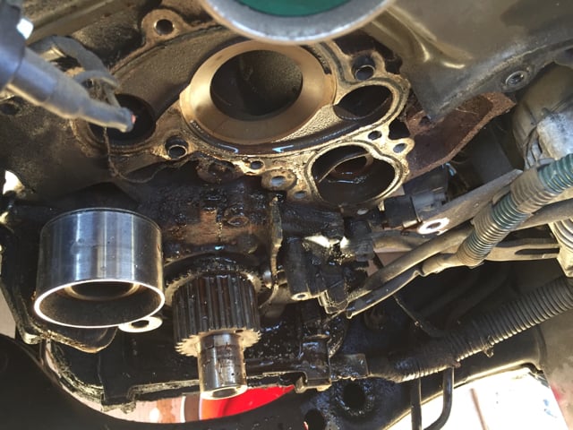

Well guys did the timing belt job today. New water pump, thermostat, tensioner and idler too. Anyhow, lines everything up to tdc, buttoned her up and BAM! That fixed it. Idle is fixed, no more cel, all is good!!!
