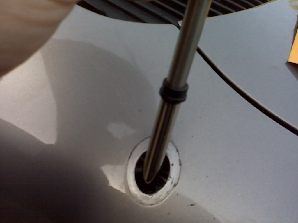

Is the black rubber boot still there? Or is it missing looking like pic below?

thanks a lot man. i just checked it and it winds up and down. well u no wat i mean it winds and winds. then when i shut it off same thing
unfortunately that's only if the power from the radio to the motor is still intact AND connected to the correct wire on the head unit :(
mine looks like normal but the antenna part is missing. i have that chrome ring. but when i look down the hole there is no part of the antenna or whatever. anyway i have the motor and shit. i just need the mask according to that guy above
Mast - correct. you'll want to take the ring off and feed the nylon teeth in with them facing the windshield I think it is - be sure to google around for correct orientation of the teeth.
So you turn it on like the antenna should normally be going up, then turn it of to engage the motor to start sucking in the nylon teeth - best to do with a friend that can do the power control while you concentrate on feeding it in.
DO NOT try to force the lower body of the antenna into the housing - if it wont slide in look for little metal nubs from crappy manufacturing on the mast.
If you try to force it down, you'll push your motor down too low on its mount and wont be able to get the ring to screw back on.
