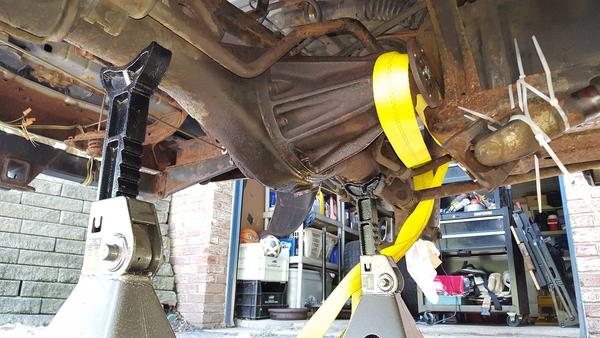

After 19 years and 292K miles the rear diff 3rd member is shot - I bought a replacement 3rd member from a salvage yard.
I have the drive shaft off the 3rd member and rear wheels and axles are out.
All 10 rear diff 12 mm nuts have been removed.
What is the best way to break it loose? Pretty sure only the factory RTV is holding it on. I have something under it to catch it.

P.S. I saw a good safety tip eariler on a Ford Bronco forum - put 3-4 nuts back on the diff loose to stop it from falling on you when it breaks free:
make sure the axles are pulled out far enough or they'll hold onto the 3rd member.

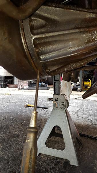

gotcha....I guess you can get a super tiny flathead screw driver, tap it between one spot then get one a little bigger and work it around the seal. I had 190k when I replaced mine and came apart pretty easily...even the one I pulled from the yard wasn't difficult.
Obviously be careful not to score the housing when prying. Good luck man.

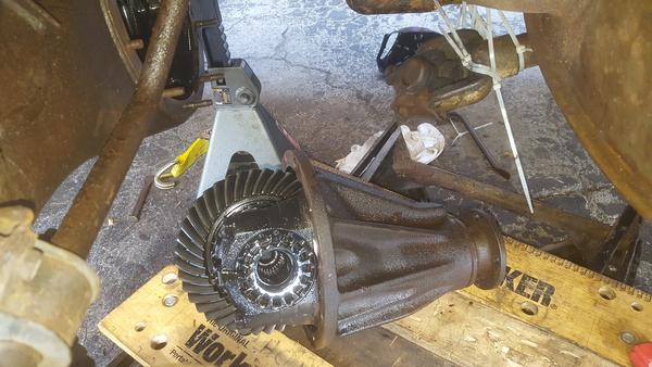

Success - the perfect tool came with the vehicle...
Used the jack to pry it open a crack and then used screwdriver, chisels, pry bars - finally came out...
Just give me 3 mm - that's all I need...
OUT!

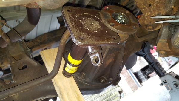

Any tips for removing and replacing broken rear diff stud? I snapped one off...
I used my cordless 20V impact driver ran a nut down as far as it would go and then reversed it - came right out...
