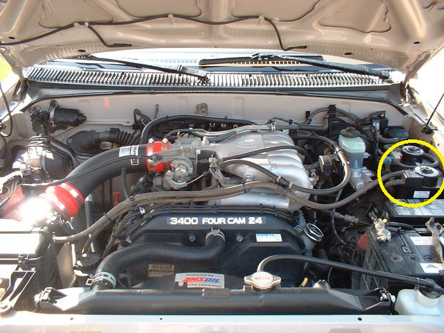

4. After the a short drive when I parked my car, I hear really light vibration kinda sounds coming from left corner under the hood near the windshield. I opened the hood and pretty sure its coming from the part highlighted in the below image (not mine, courtesy google images). The sound (light ghrr.. ghrr.. ) comes in a rhythm which gradually decreased as the engine cooled down. Whats that?

That's your charcoal canister. Probably just hearing pressure venting from the fuel system.
That sounds assuring, so nothing serious. Any help on the other issue which I noted? I was thinking of getting a genuine Toyota replacement key from the dealer to see if it fixes anything. But not sure how much they charge for that!

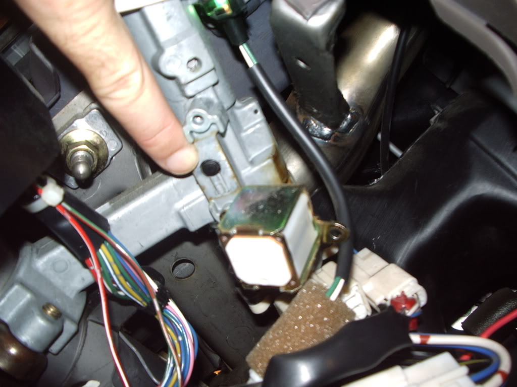

Fixed this issue. Well not exactly fixed but atleast the key would not get stuck again. I just disconnected this solenoid mentioned here -
Key won't come out, what's this part?? - YotaTech Forums
Did not removed it, just unscrewed it and turned it around halfway so that it does not touches the black switch - used only one screw instead of two. Now the key would come out in any gear, hope it does not gets stuck anymore.
See photo for the same part from yotatech.
