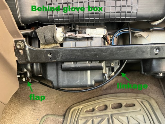

97 T4R with manual environmental controls (levers with wire linkages).
The linkage is to move a flap below the glove box that opens/closes the supply of heat but the linkage does not close the flap (moving the lever to heat); if the flap is manually closed (heat position then does provide heat) moving to the cold opens the flap (wire retracts linkage to the flap and the flap is opened).
The cold/heat linkage won't go all the way to the left (approximately stops at 1/4 up from the cold position) and does go all the way to the right (heat).
If I assist the flap while moving the lever, I can feel the linkage's pressure but it isn't enough to move the flap; it seems that the linkage rather deform (it shifts position) when moving the lever to the right (heat).
Any ideas?

well this was weird
i was checking the linkage (moving the cold/heat lever environmental control) and moving the flapper valve back and forth (in no particular order)
something made a 'clunk' sound
and now the linkage properly moves the flapper valve open and closed
there must be some intermediate connection between the cold/heat lever and the flapper valve that now is articulating properly
