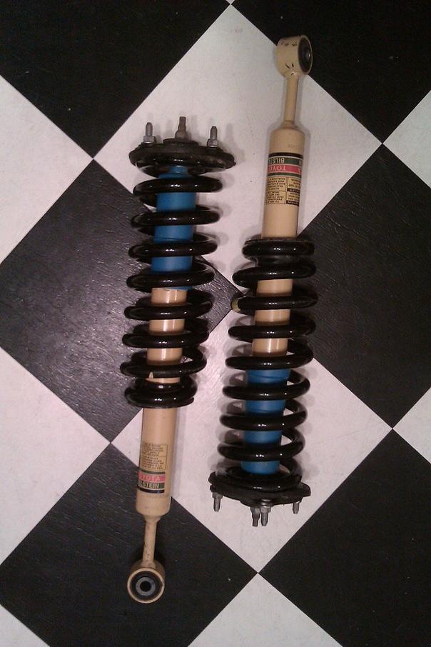

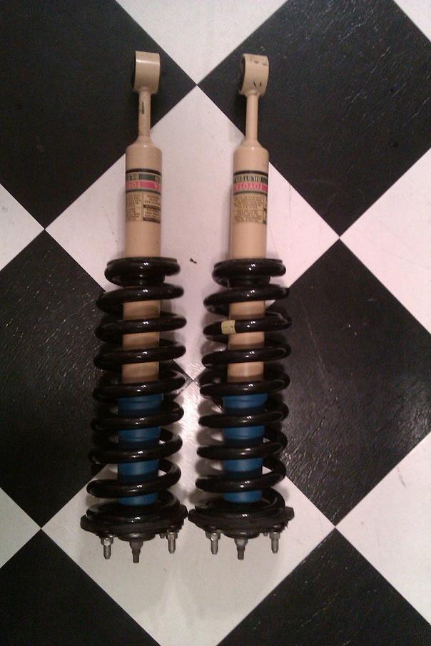

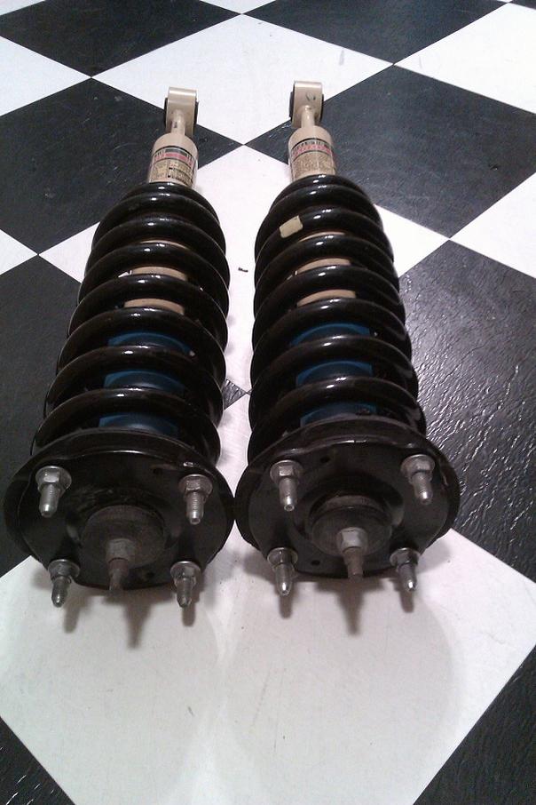

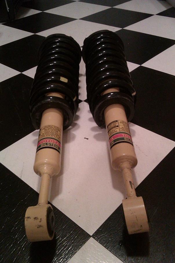

Gota pic? I'd like to see what you have there.
sure do... posted them on CL just a bit ago asking $350 obo we shall see... but if you guy think i can make them work or change out the top plate for a 3 stud one then should i keep it, and try and use them? -paint code is yellow yellow, yellow blue. and the part number on the strut is 48510-OC030

Dang dude, it's hard to say for sure but they look like they may work. Seems your 3rd gen top plate would work. Just measure it and make sure it's not too small to capture the springs and you should be good to go.
2 things I would be concerned with is how much lift you would get and how stiff of a ride you'd get. Somebodies gota experiment right? seems like you have the perfect set
Those look like they're way too tall for a 3rd gen. I'd try to sell em, you'll make a profit either way, and order something that you know will fit.

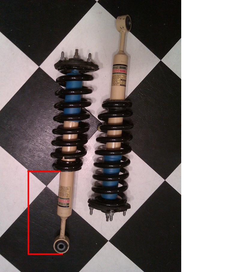

What does the part in red measure out to be?
11.5"... yeah them being too tall is my only concern. overall from the top of the top plate to the bottom is just a hair under 25.5" and from the base of the top plate to center hole on the "i" is 24". im not sure what the measurement on the 00-06 tundras is so if anyone knows that could really help out here.
Yeah, someone that has it assembled but not installed yet since the weight of the truck would affect the measurement.
I should have a set of 00-06 tundra setup coming in a day or two and I can measure it if no one else does in that time.
Hey so I just got mine in and they are 20" from the top plate to the bottom of the shock. They are 7" from the coil perch to the bottom of the shock. Looks like you are SOL. Might as well try to sell them.
