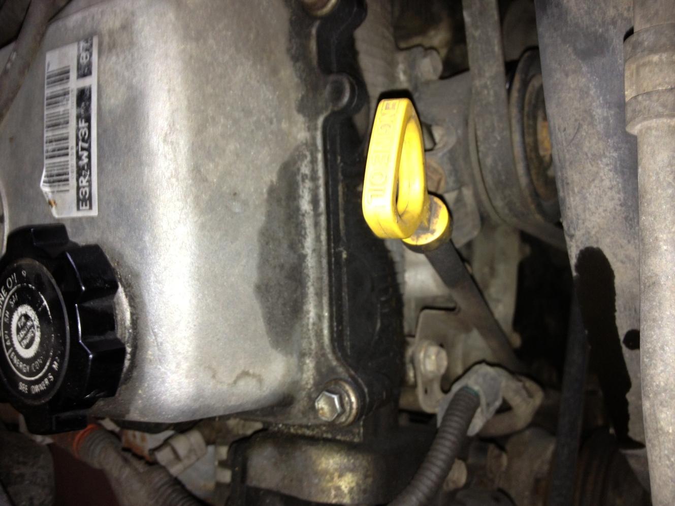

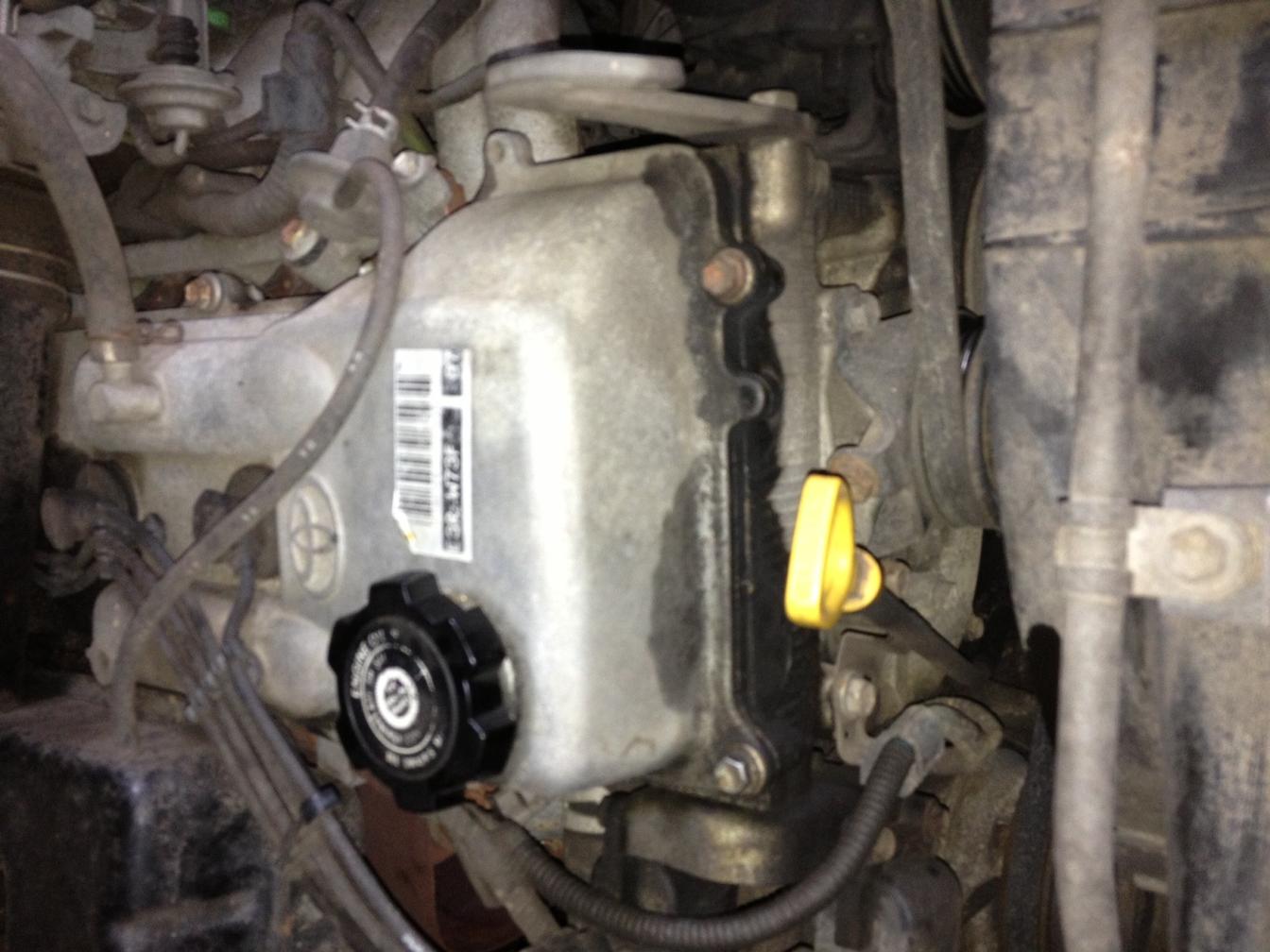

Almost positive valve cover gasket is leaking on my 3rz. My mechanical knowledge is pretty limited so I'd appreciate affirmation. Should this be an immediate concern? I'd like to hold off on replacing gasket for a month or so.

There does appear to be a small seep there. A month isn't going to cause any damage. You should only be concerned if it is pouring out and the oil level drops constantly. Just check the oil once a week to be sure. I have had a couple of 3rz's including my current one go well over 200k with no issues

If you are just tighteneing the bolts, don't crank them down too hard. The torque spec for the VC bolts is like 4ft-lbs. or something. It would be easy to overtighten and crack your valve cover - which would be bad.
Snug em down a bit, you'll be fine till whenever you can change the gasket.
I missed how many miles you have on the engine, but that minor seep I wouldn't even bother with it.
Take some engine cleaner / degreaser / Brake clean / WD-40 and scrub with a small brush, then hose off gently on a cold engine.
Until it starts dripping and affecting oil level I wouldn't worry about it. That could be years, or never at that rate. These engines are 15 years old. They are known for valve cover seepage. Not a big deal. A little oil can make it dirty or dusty engine look like a big leak. That's a tiny seepage.
