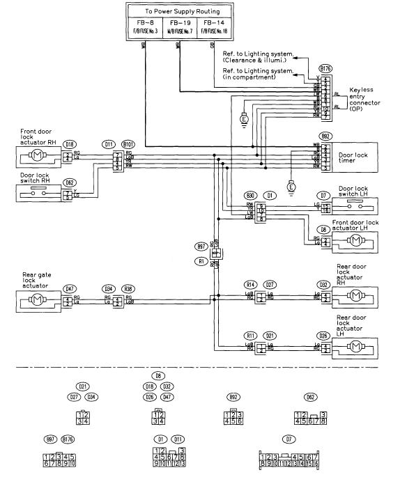

I have a 98 forester with phantom power locks. They lock and unlock by themselves, driver side doesn't work at all, passenger side only works when it feels like it.
I replaced the switches on the driver side. That didn't work. Checked all the fuses under the console and under the hood.
So it has to be a bad wire or a relay right? Hopefully it's a relay.
What iv been looking for is a schematic that shows which relay does what and I can't find it anywhere. Everything iv seen just says "it's a relay" with no more explanation.
Does anyone have access to a relay schematic for a 1998 Subaru forester? I'm going to get under the hood and take them out 1 by 1 after work today to see if that works I guess...
Doesn't look like there is a relay. Just a "Door Lock Timer"
Check out these pictures to see if they help out.

I have literally no idea what to make of those. I'm sure they are helpful, I just don't have the electrical knowledge to put them to use. I guess I'll just suck it up and take it to the shop :/
