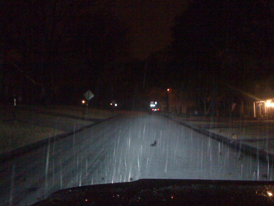

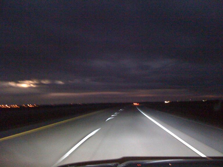

I think the whole drop in HID's and 99+ stock housings discussion is way too over analyzed. Yes, some other cars housings absolutely suck and blind you when you are coming the other direction, I've witnessed it many many times. However, of the year and half I have owned these drop in HID's I have yet to be flashed EVER. Grant it, there is a big difference when you go with crappy HID's and a very good pair of HID's. In which I have a very good pair of fully digital bi-xenon HID's.
If you have the money and time, sure go with a projector retrofit. The difference is night and day over anything. If you want to run drop in HID's get some 99+ OEM headlights and don't skimp out and pay for the cheap HID kits. If you would be happy with high output halogens then get some IPF's, PIAA's, or Sylvania Ultra’s like you had before. All in all, be smart.. do your research and don't always go for the cheapest.
On a side note.. me and a local buddy of mine both have Retro Solutions full digital bi-xenon kits in out 99+ housings and the output is great with very minamal glare. I have 55w 8k kits and he has the 55w 5k kit. See mine for yourself.. Both pics of are low's. I don't have a picture of the highs.
In regards to "the kid's" reply. I agree.. Most people will drop some HID's in anything and not think twice. Some headlight housing do better than others but most out there cause some crazy glare. I don't want to be stereotypical about this subject since I obviously have HID's, and yes there is technically still glare with mine. I did a lot research first on this subject and I wouldn't have made the purchase/ decision I did If I knew I was causing harm to others on the road. Now, if you drive a really lowered ass car/truck I can't help it that my truck just so happens to be lifted and blinds you when I come up at a redlight. I would have done it regardless HID's or not. Yo life, yo fault :D
