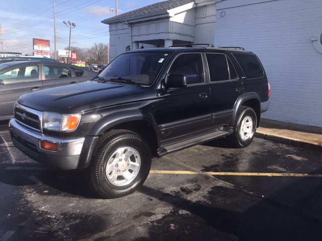

So today I go looking for a van for my mom and I spy this not even listed yet.
98 4R Ltd, black with 244K. 1 owner, local trade to Toyota dealer.
No fading, scratches or dings. All door edges good too.no rust.

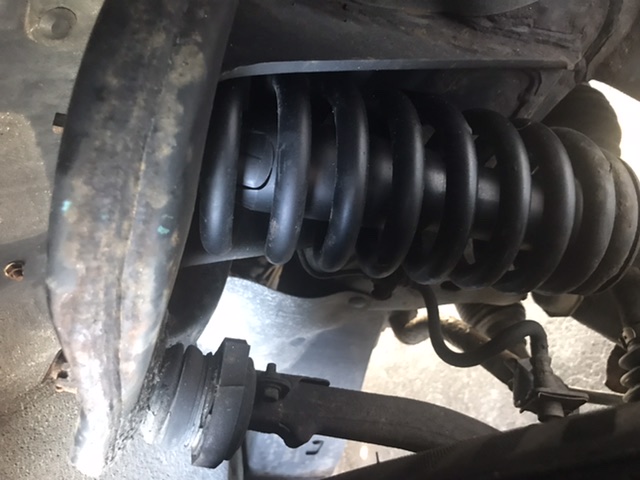

So I crawl around under it and was shocked at the glamorous black frame with very slight rust.
Coils, shocks etc look brand new and every bolt looks turnable. Even the rear diff.

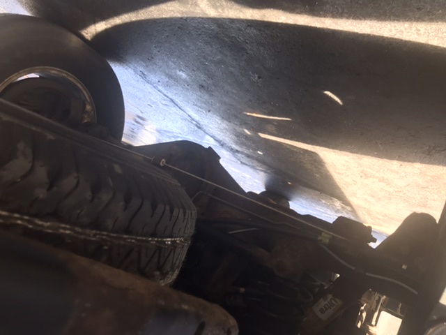

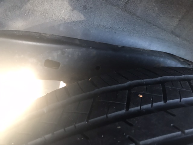

It has a fair amount of undercarriage rust, seeing in the upside down pic with spare. Id do a lot of probing the frame. I don't see any pics of the rear lower control arm bracket (the hot spot). Need to check out the inner side of frame at the muffler also. Need to climb under and inspect the frame from the inner sides, not just the superficial areas. Be careful, check it thoroughly, especially in your salty region. Doesn't look like the owner did any rustproofing
For Chicago, that looks like minimal frame rust to me. Agreed that is important to have a close look at those particular areas, however.

The 96-98 are the "3" / 6 spoke rims and are the correct rims for that year. In 99 they went to the 5 spoke wheels.
Those look like aftermarket quickstruts on the front. They are typically a short lived stop gap. See what brand they are, you may have to do them sooner than expected especially if they are Monroe.

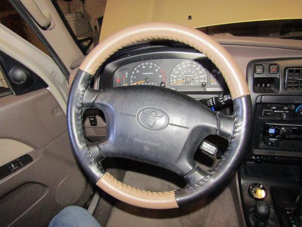

[MENTION=115347]gamefreakgc[/MENTION] got any pics of the steering wheel cover?
Bad photo on my old camera, but here it is. I don't know why it looks so yellow, the tan really is a very good match. Can also get pure black but I liked the two-tone.
