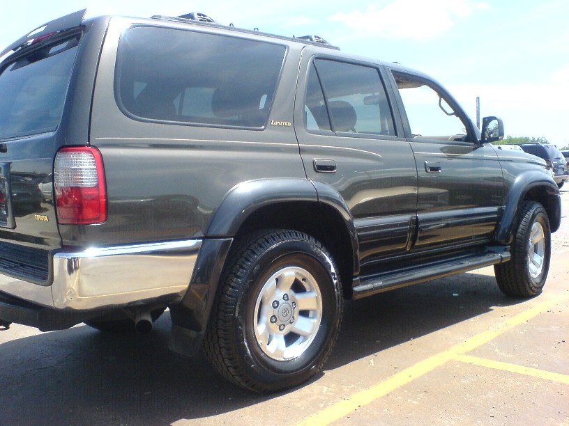

Yeah, I like the car very much. Here she is....beauty....

Yes quite beautiful. Much better than my $8K recent purchase of a 1998 with leaking axle seals. :( It does have a few less miles though 116K.
