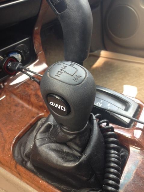

Correct. The shifter looks like this:
Press the 4WD button on the side of the shifter and it'll shift into "H4" (which is AWD).

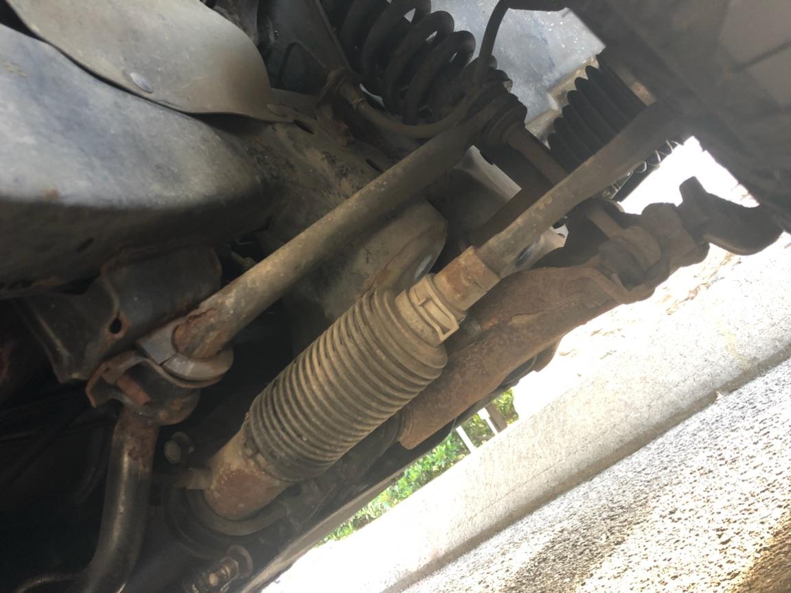

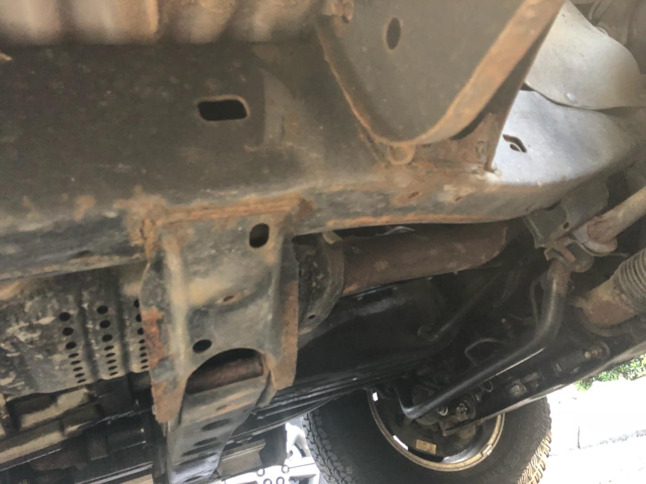

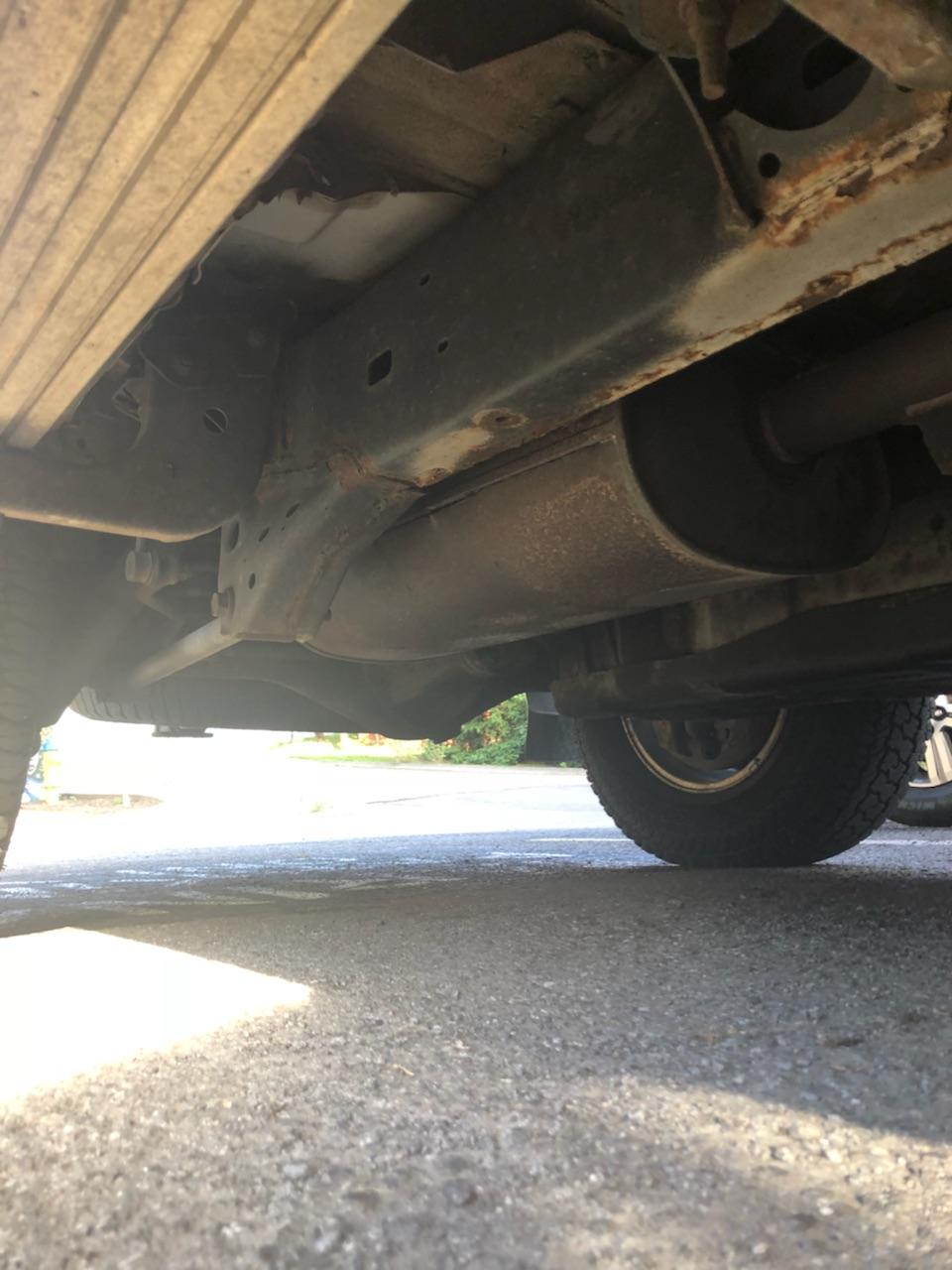

These are the undercarriage pics he sent me. I don’t see any real frame rot, but the front end/ball joints, etc make me a little nervous. I really don’t want to get it home just in time to do the whole front end. I’m going to do the lower ball joints (been there) either way, though. Thoughts?

That's rusty by west coast standards and pristine by north eastern standards.
There's a lot of truth in that statement. So do I take it or keep searching? I've looked at so many I'm starting to wonder if I'm going to find a REALLY clean one. On the other hand, I've waited this long so I can hold off if I should.
Charles
... So do I take it or keep searching? ...
Leave it.
#1 problem for me: Too expensive for what it is.
#2 Too rusty. What is too rusty to a central Texan? When I can clearly see it is pitted. That isn't just surface rust, it's pitted through the frame and that is in what little the pics show.
Keep looking. Go further south and southwest. They're out here and they don't cost $9000!. Here's a couple: https://austin.craigslist.org/cto/d/1999-toyota-4runner-4x4/6603405379.html and https://austin.craigslist.org/cto/d/traderunner-e-locker-ome-lift/6600951292.html and https://sanantonio.craigslist.org/cto/d/2000-toyota-4runner/6605535976.html and https://houston.craigslist.org/cto/d/toyota-4runner-4wd-limited/6607820584.html Luck. :cowboy:
Yeah, her in the salt belt I'd count myself pretty lucky to find one in that condition.
Every once in a great while I have a half a thought about trying to stick a multimode xfer case on my manual trans 99, but an AWD mode that I would probably almost never use is probably not worth the effort.
PS: It's also worth noting that when a frame fails from rust, it does so from the inside out. What it looks like on the outside isn't the important part. I'm always very careful to spray lots of water in the few holes on the outer sides of the frame that I can get to when washing my car - to make sure I rinse all the salt and dirt out of the interior of the frame. That's where it can accumulate and hold moisture and salt against the metal for long periods of time.
When I first got my '99 and did that for the first time, a *huge* amount of dirt came out.
After looking at the pics, I've decided to pass. The body and interior looked really good, but the underside, particularly the front end, make me uncomfortable. I guess the search goes on. I've got pics from a '99 ltd in Wichita coming. Maybe it'll be the one. If anyone comes across a really nice one, please pass it on.
