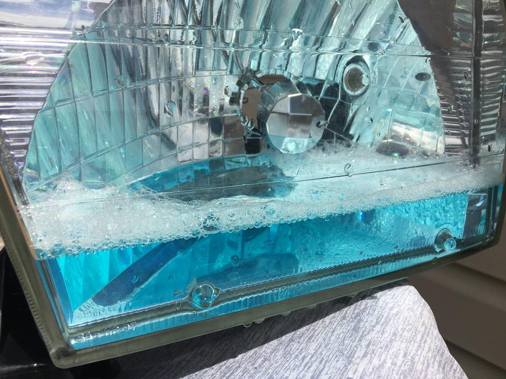

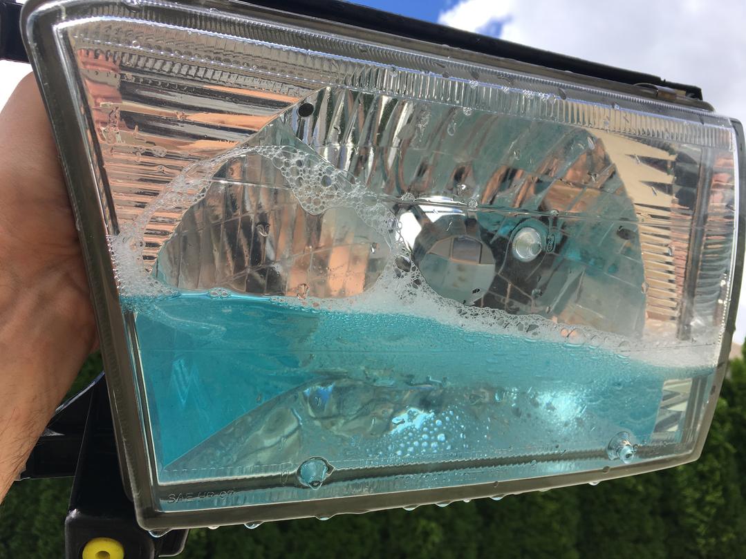

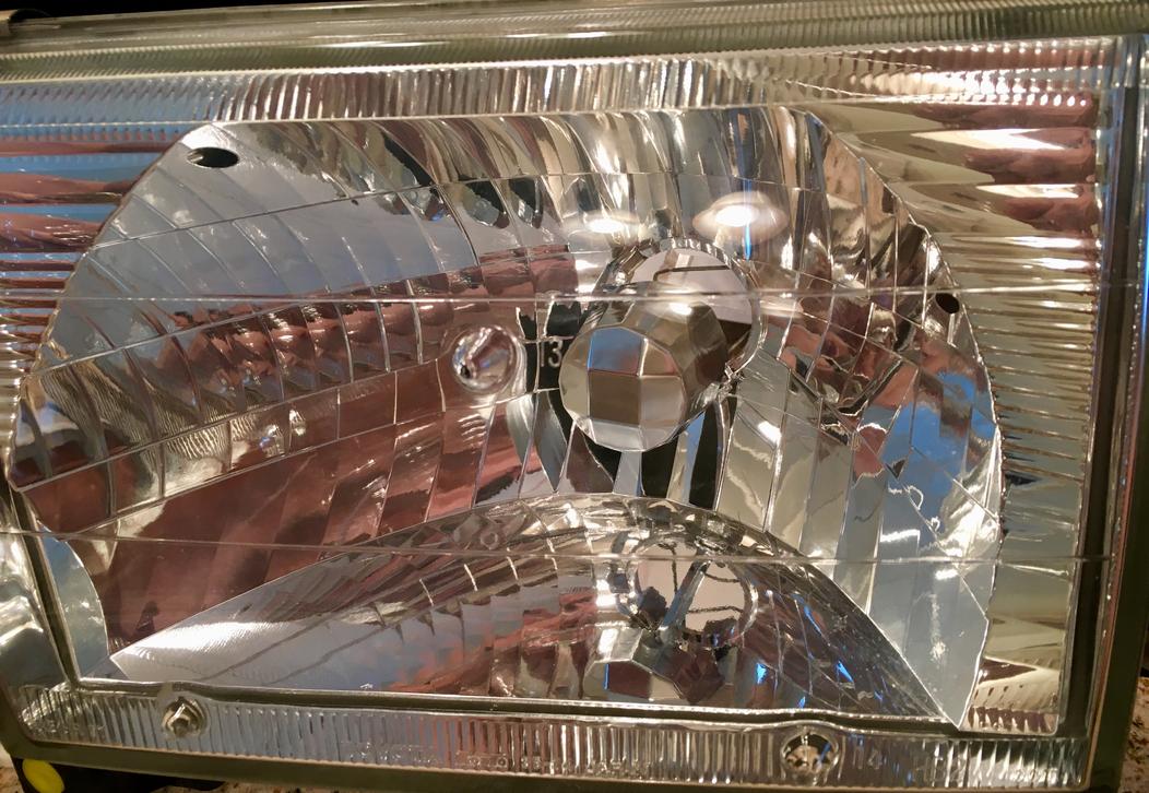

OK, this did the job. I filled the lamp off with warm water and windex 2-3 times and added some ice cubes to help scrub the inside while shaking, then rinsed 2 times with tap water, THEN final rinse with distilled water so there wouldn’t be spots, then used hairdryer about a foot away for 10 minutes. Looks perfect
Wow, that actually worked! Didn't know it was possible but that really cleaned things up.
The ammonia in the windex might not play well with the metalization on the reflector. That stuff is literally microns thick. Be careful with exposure time if you decide to take the risk.
Yea, it wasn't in there long and was on 1 part windex to prob 4-5 parts water. Then rinse with tap water a few times, then final rinse with distilled water.
