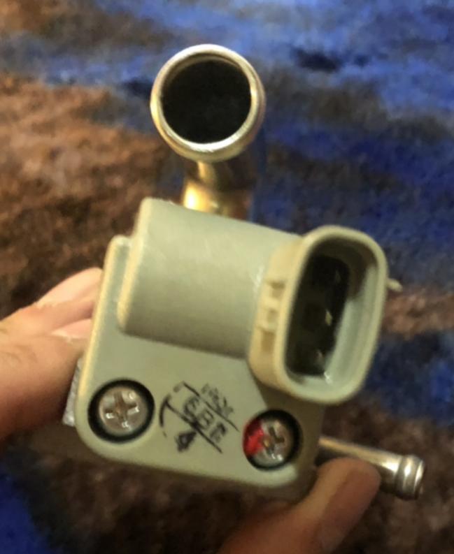

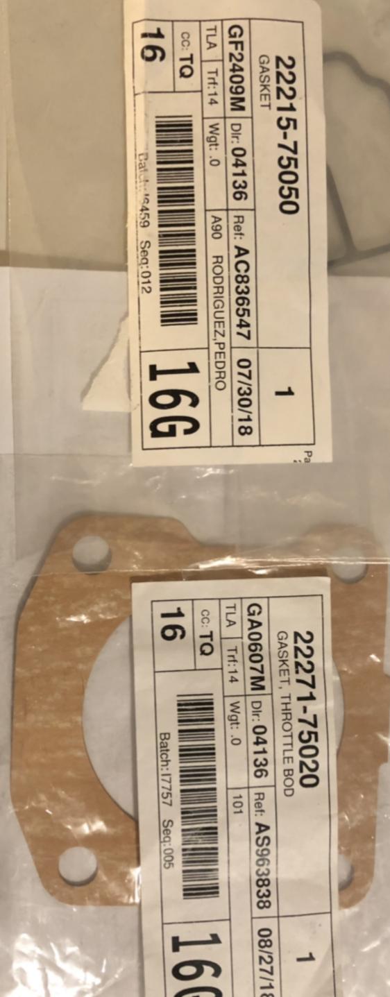

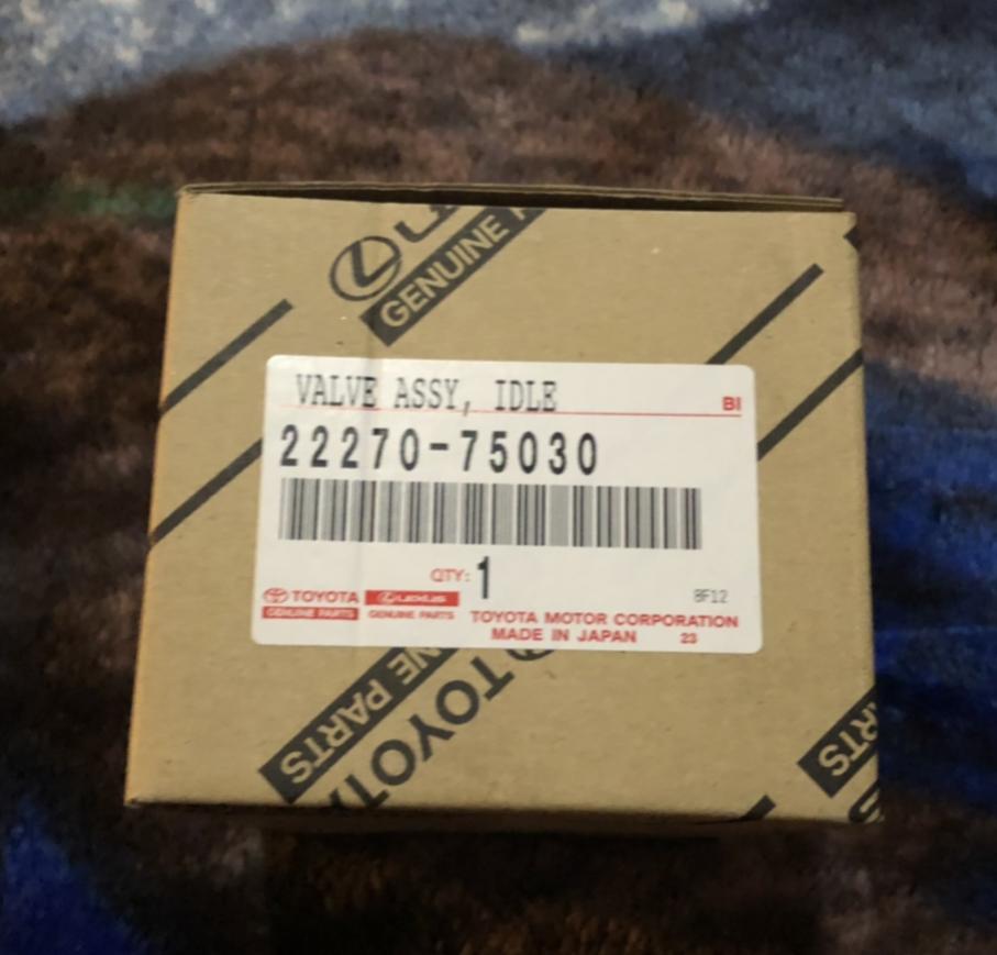

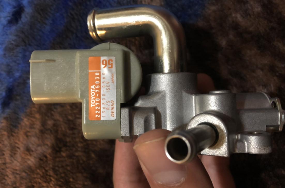

I got 22270-75030 valve assy , idle speed control
22215-75050 gasket idle
And
Gasket throttle body
22271-75020
I will do it to save $270 from dealer labor
I am going replace this tomorrow let’s see what happens
