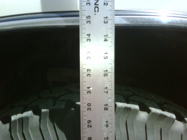

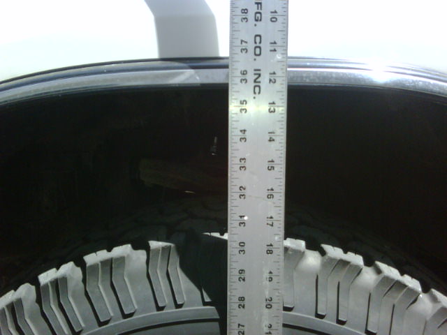

On my Wife's '97, in the front, went from about 34.5 to about 35.5 after the '99 coils and Tokico Trekmasters.
