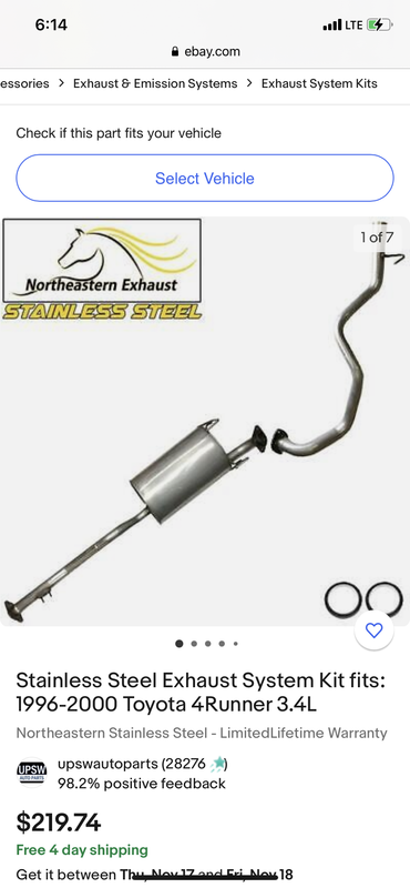

The eBay reviews are good for the Northeastern 4Runner exhaust kit linked earlier. This eBay listing (screenshot of the eBay listing is posted below) states that this kit is for 1996-2000 3.4 4Runners. Why are 2001-2002 4Runners excluded? I have a 2001 4WD Limited (non-California).
The muffler pipe maybe different in the last 2 years [2001] [2002] as for they all have 2 cats and probably slightly different lengths on that pipe. :)
