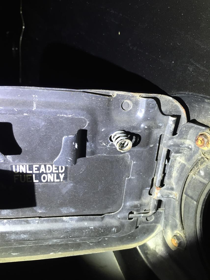

Underfire you can use any small spring to fix the door. I threaded one into a hole on the door and it has been working fine for 4 years now. OP if you cannot find one that is the right color see if you can pull a hinge off another one and use the original door. If it was put together, it will come apart.
