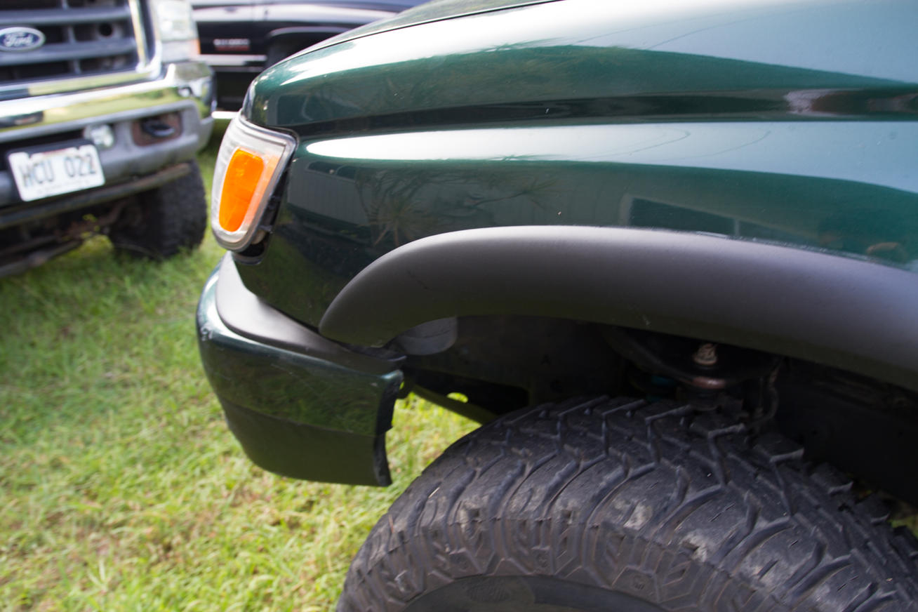

I was recently backed into by a friend, not too much damage but my fender and bumper were pretty bent. I just ordered a new fender and installed that

Damage:

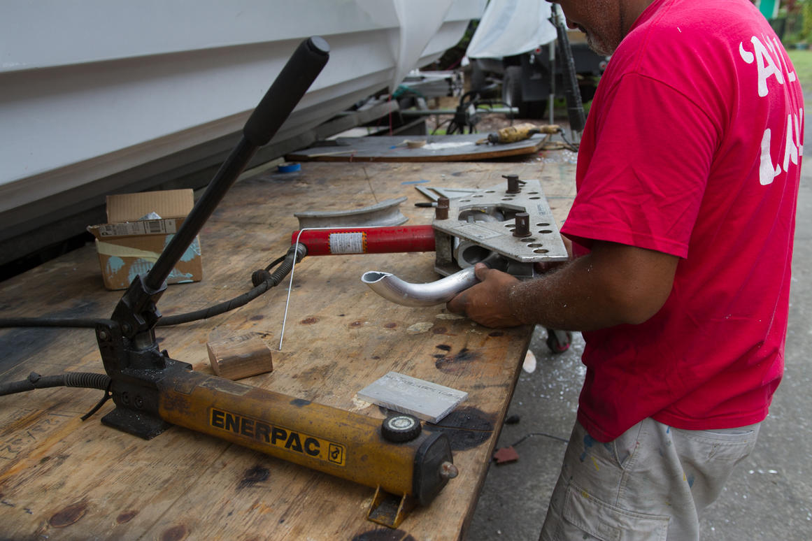

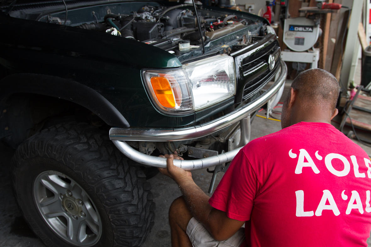

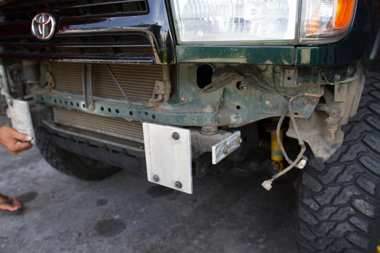

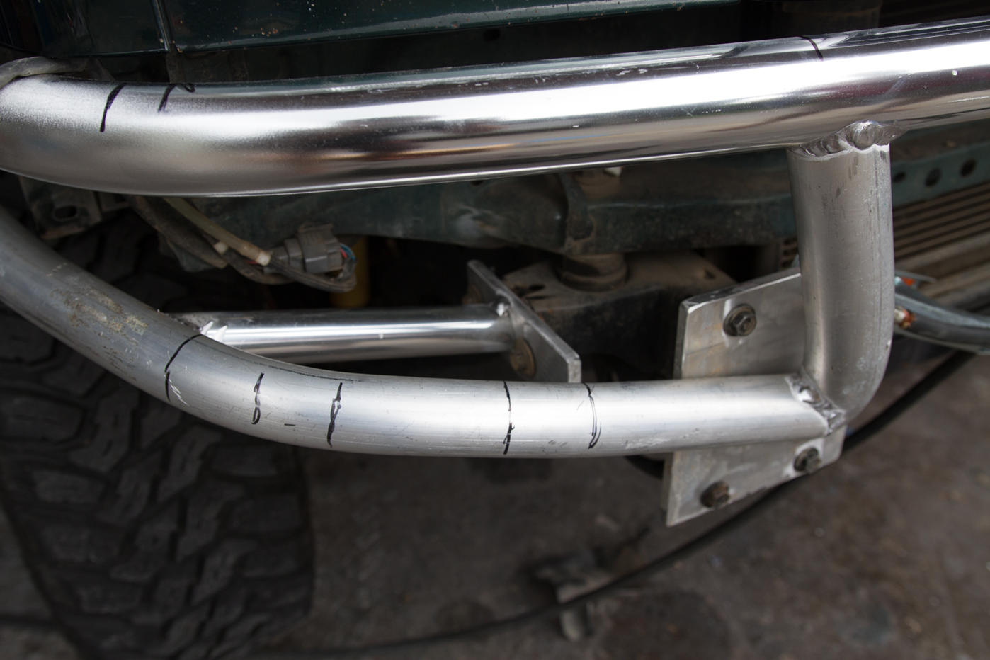

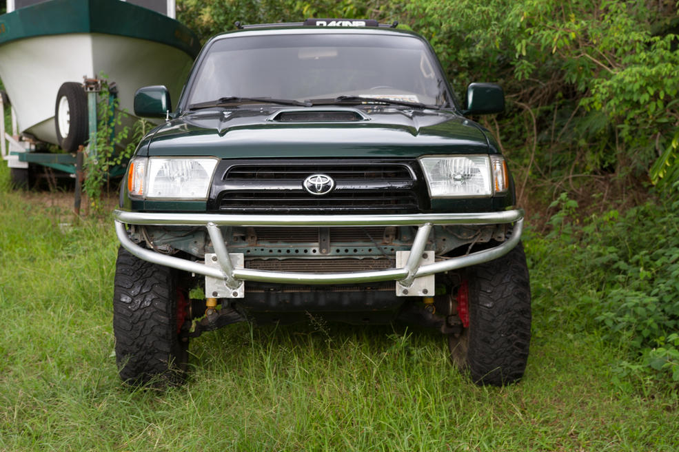

Started by making aluminum brackets to weld to, this will allow the bumper to be removable

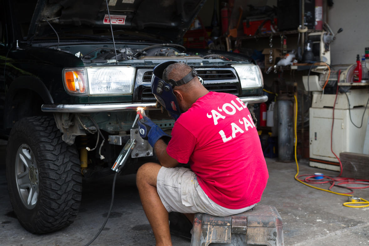

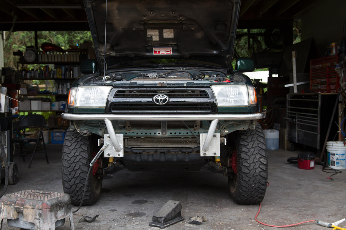

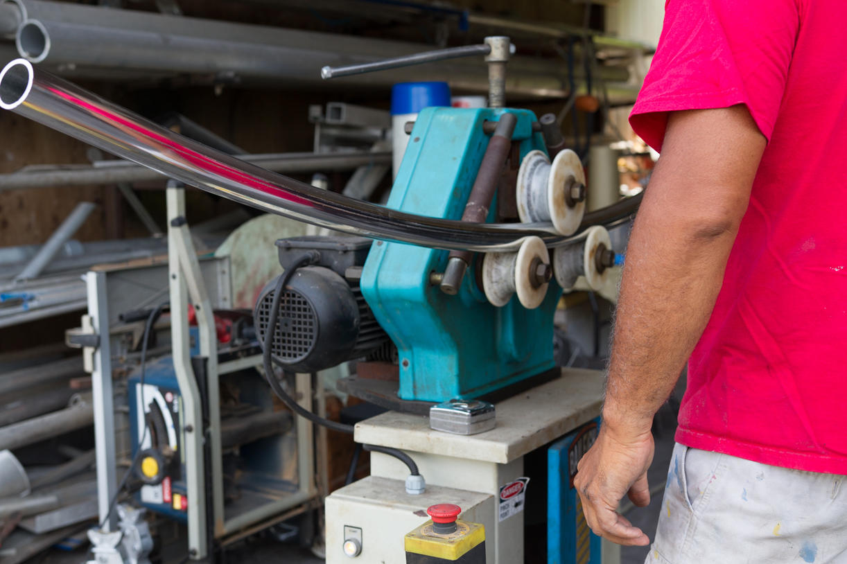

We rolled all the pipe right here in my garage. Here is the main top cross bar - welded on
Any tight bends that were to sharp for the roller we bent using a hand hydraulic pump pipe bender

welded braces to the brackets
Frame all finished

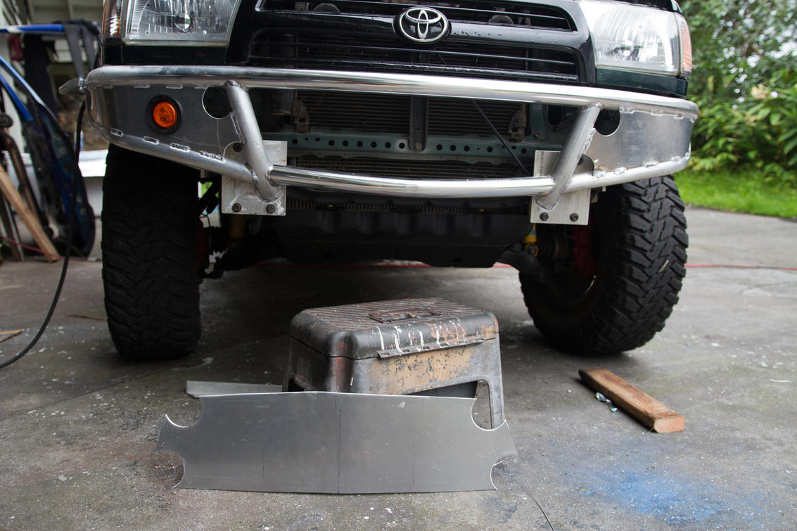

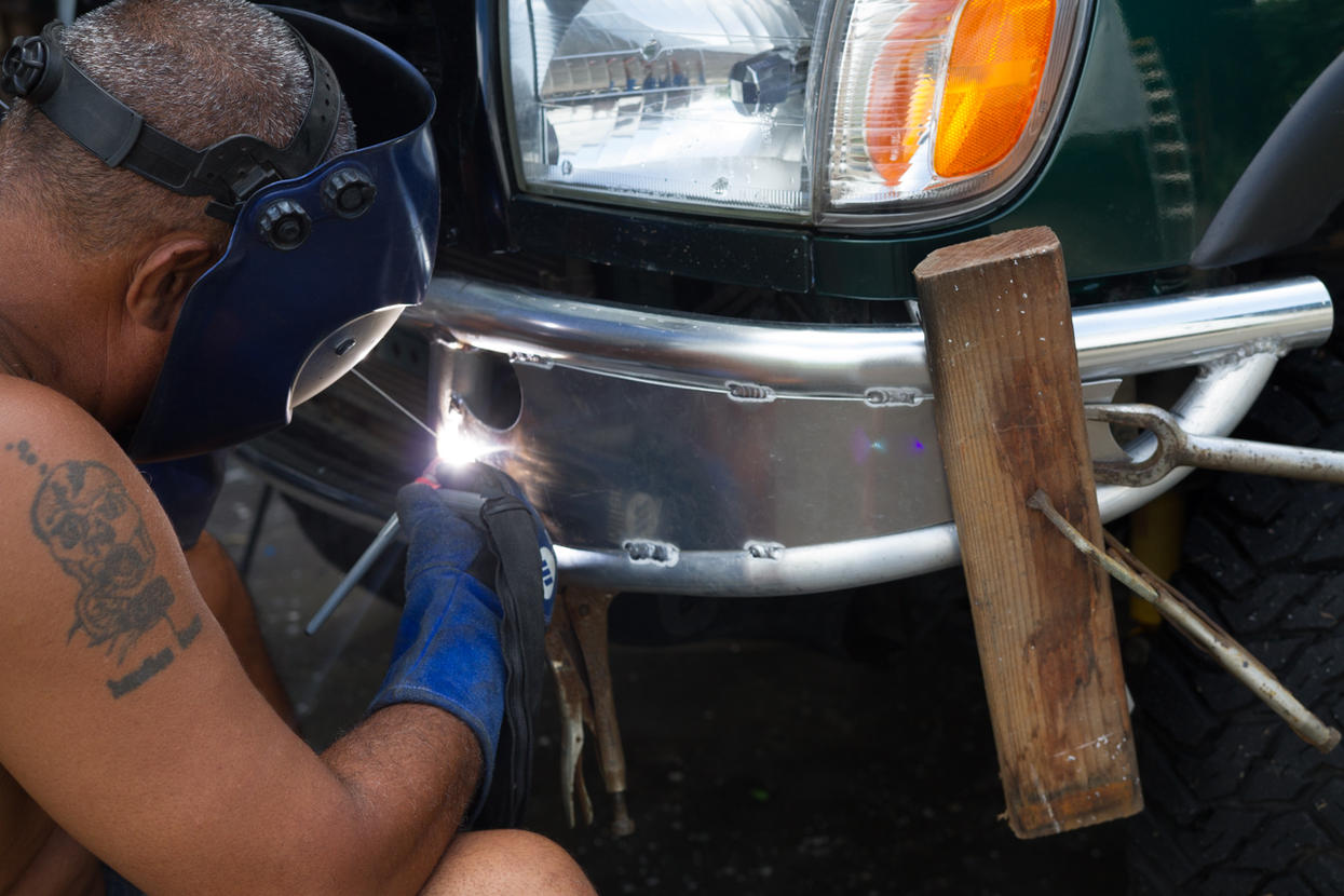

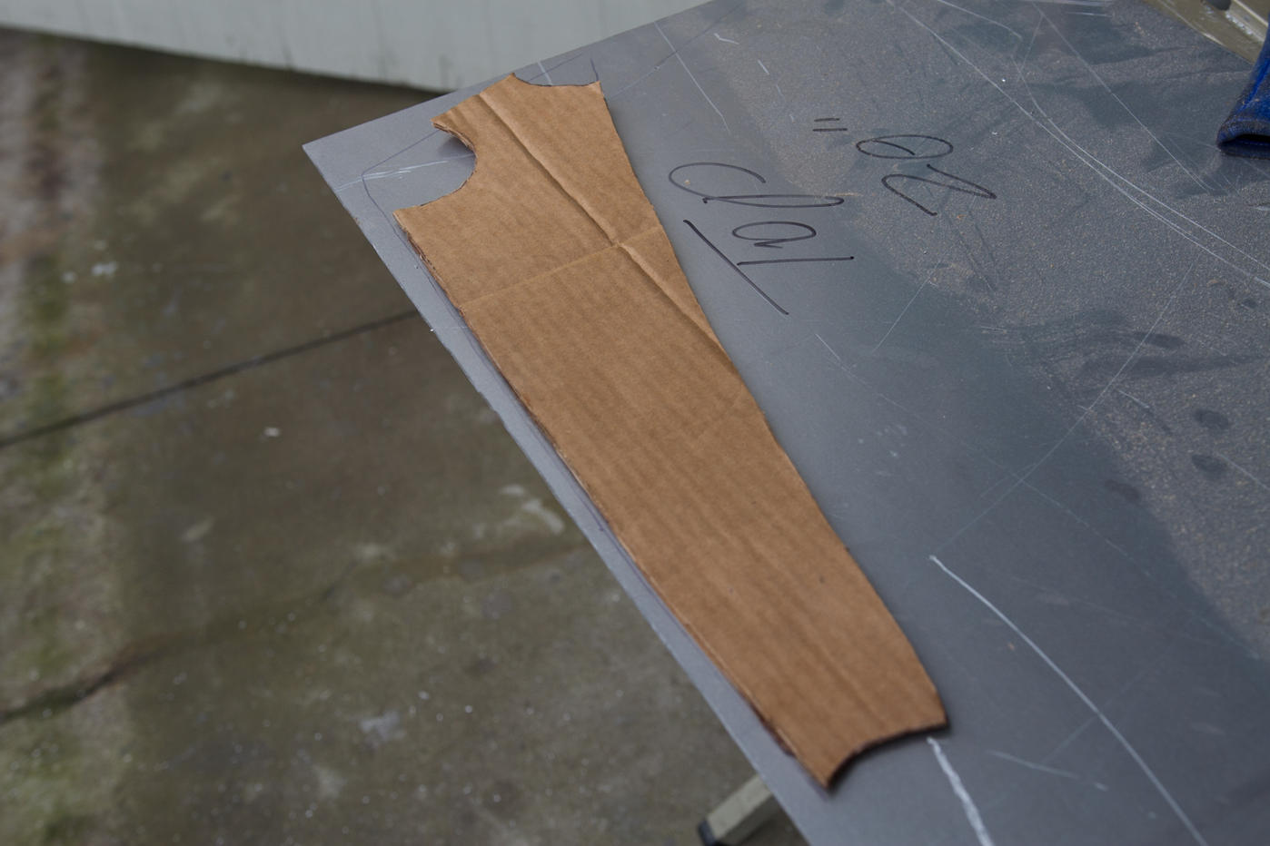

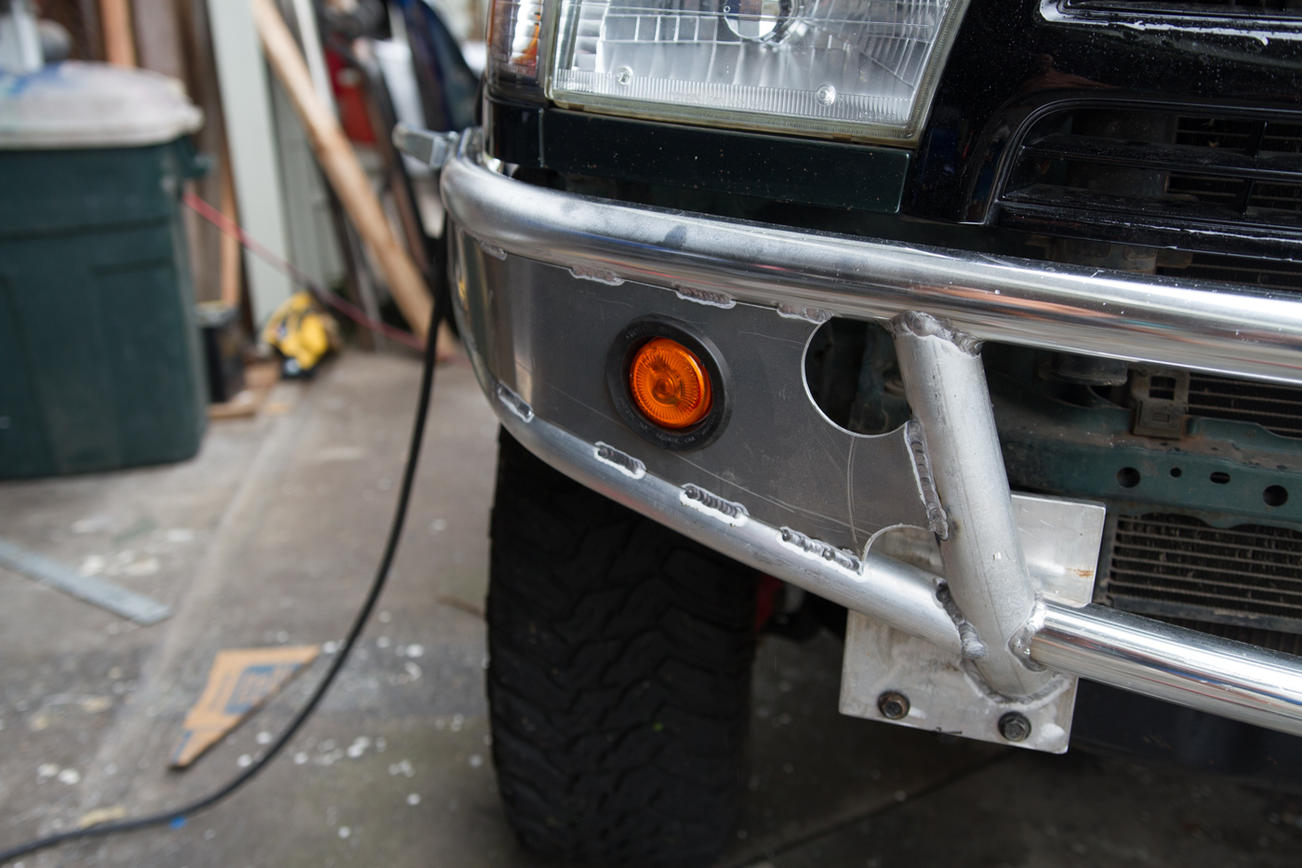

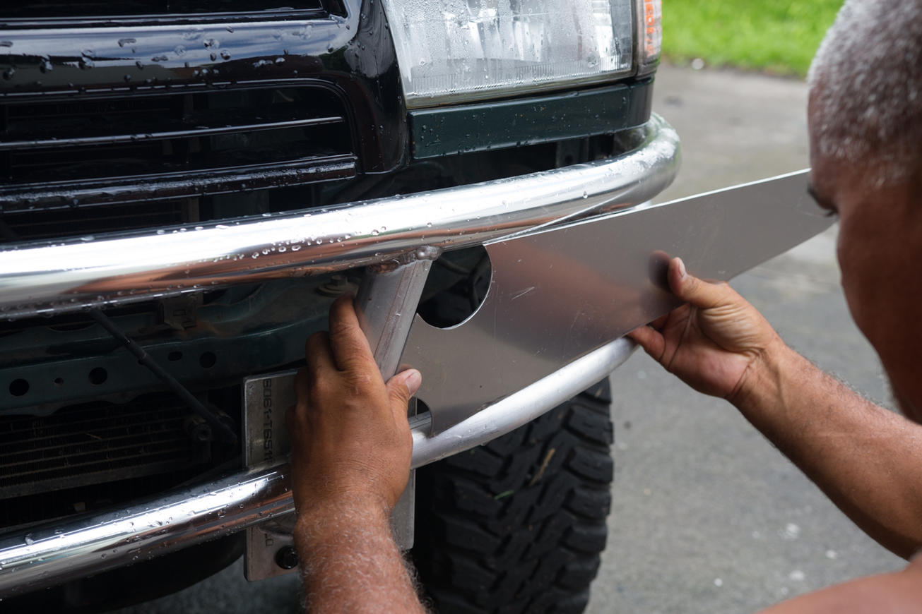

Went on to add aluminum plate, we made templates out of cardboard
One side all tacked up

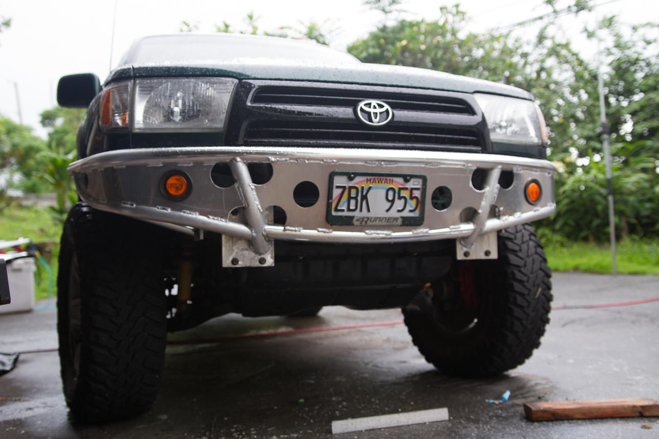

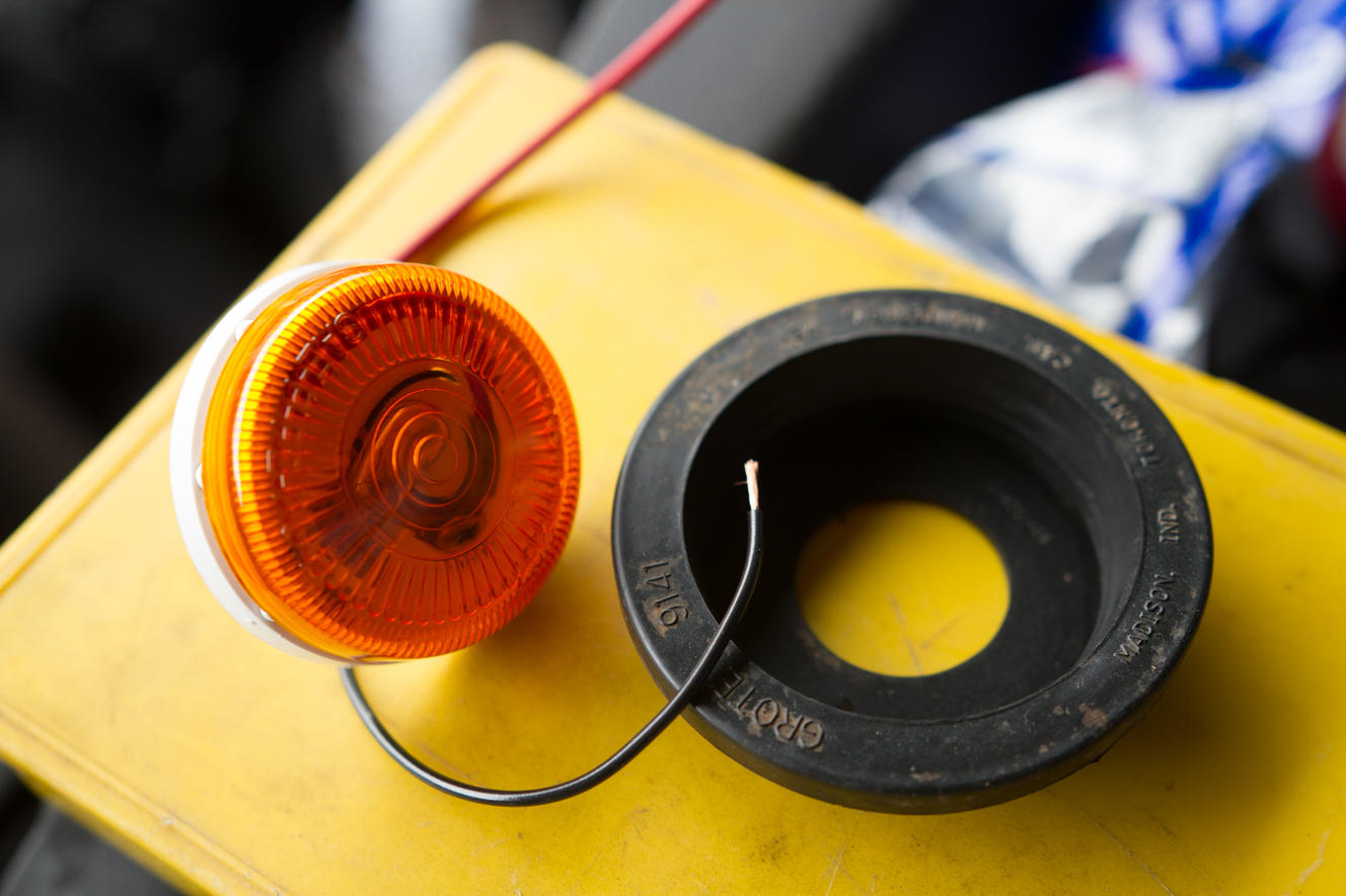

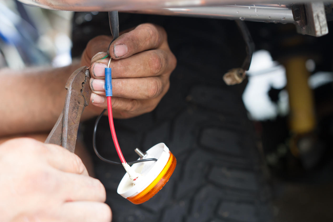

Got a couple circular turn signals at a local truck shop - drilled holes and installed them into the 2 side plates
Got them all wired

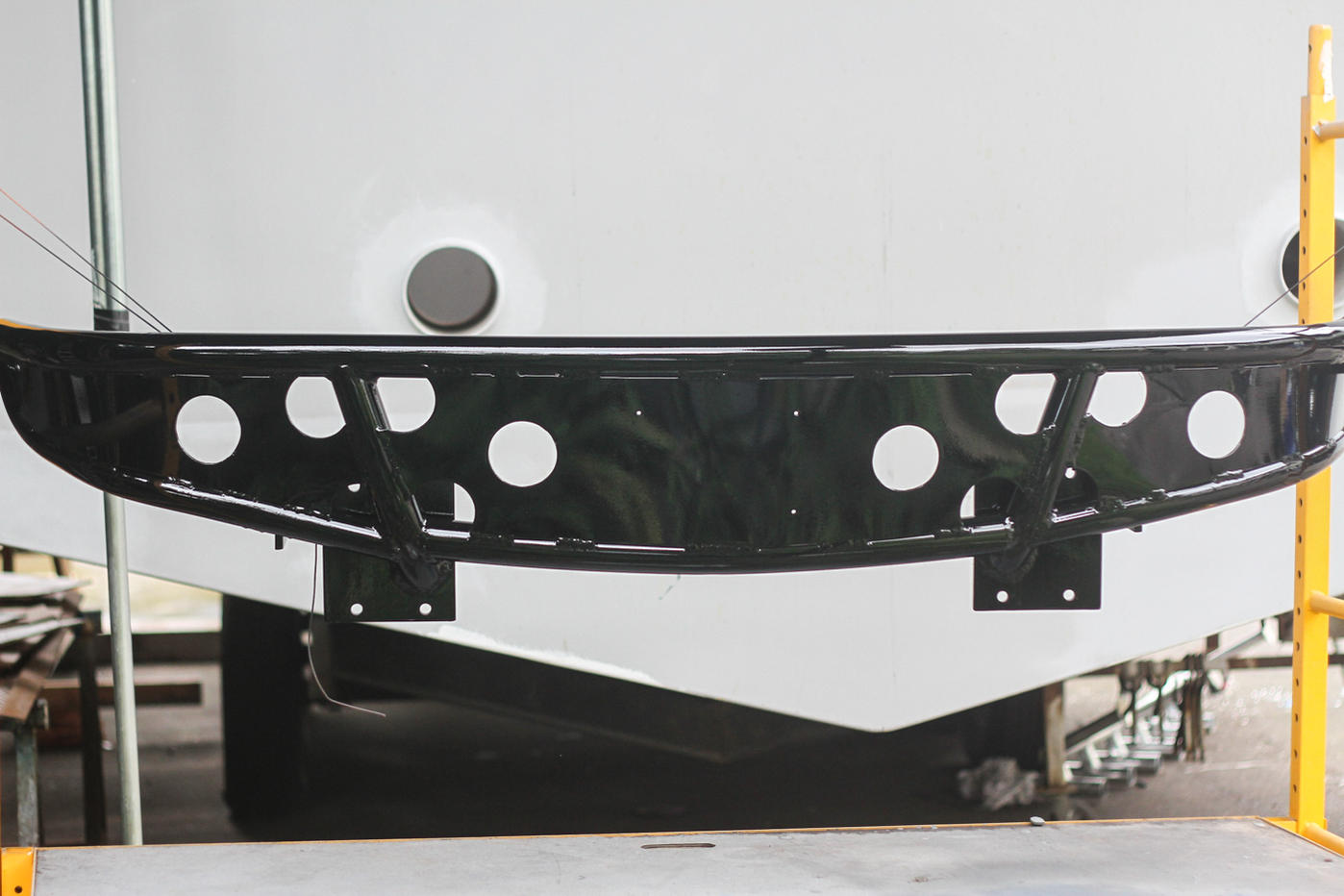

Middle Plate cut out
All the major work is finished
I know it kinda looks like swiss cheese right now with all the holes, but I am gonna paint it black within the next week to match the car and not
stick out and be so flashy. Ill keep this thread updated once I get the paint on, comments welcome, thanks

Looks very good! Fill the holes with a bunch of fog lights!!!
Haha I was definitely considering filling in a couple fog lights! Im not sure how I feel about all the corner holes, I might fill in a couple of them, but I think I am gonna paint it first to see if they are very noticeable.

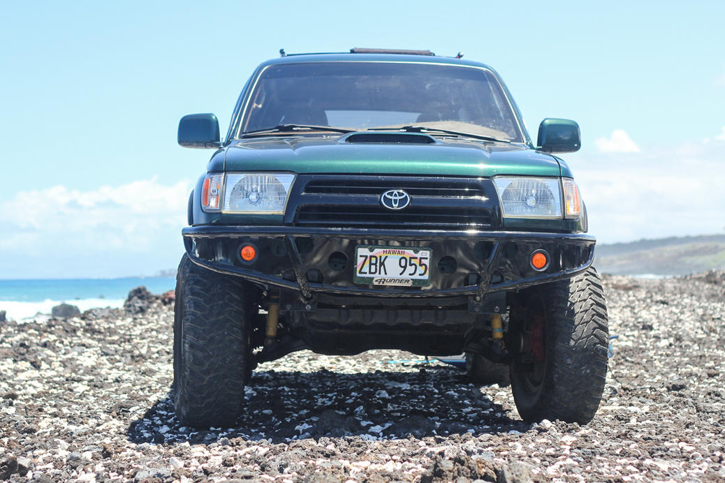

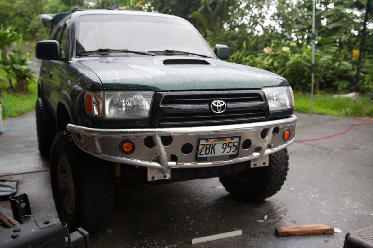

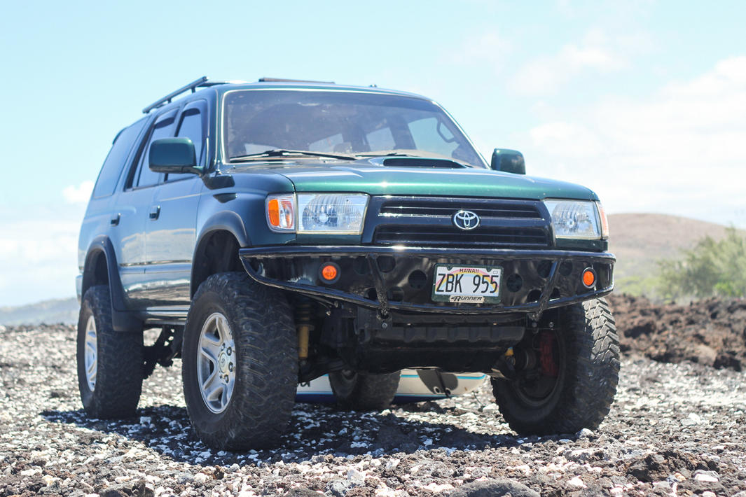

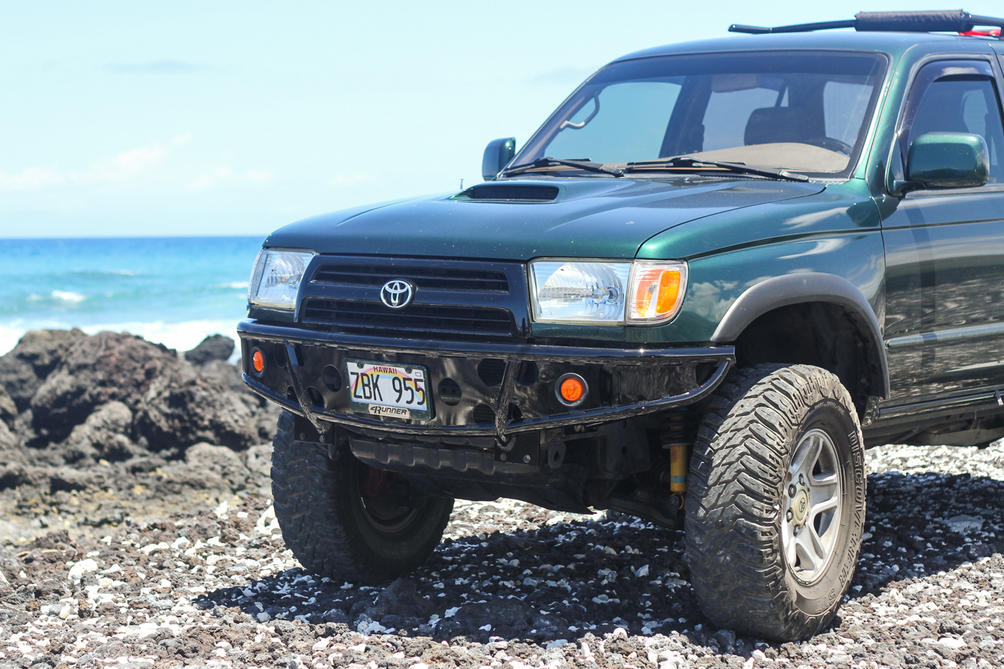

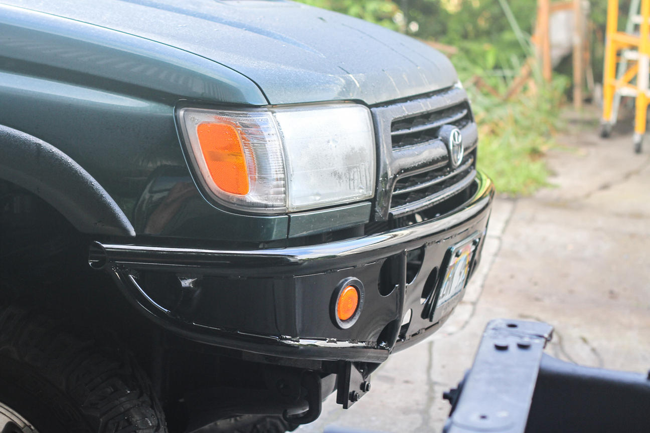

Finished Product!
Gave it an acid wash and light sand to prep it for the primer and paint.

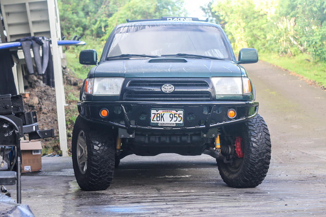

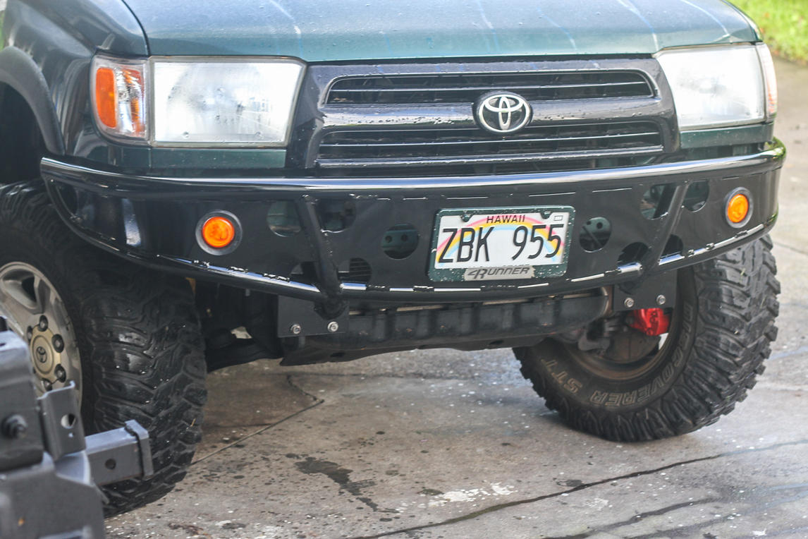

a couple coats of primer & paint and here it is.
Looks much better in my opinion! I am extremely happy with the result, no more bent bumper!

Wow good looking. The gloss black really makes it pop! I wonder if you could build an aluminium bumper strong enough to handle a winch.
