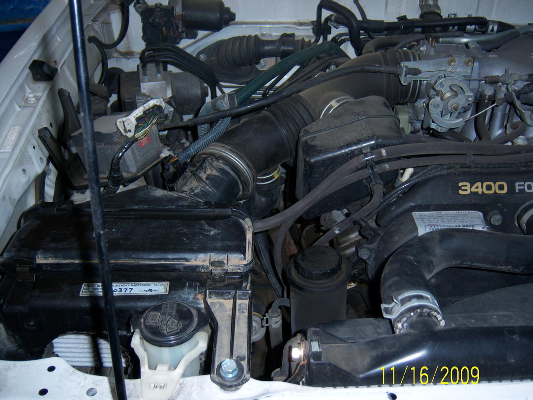

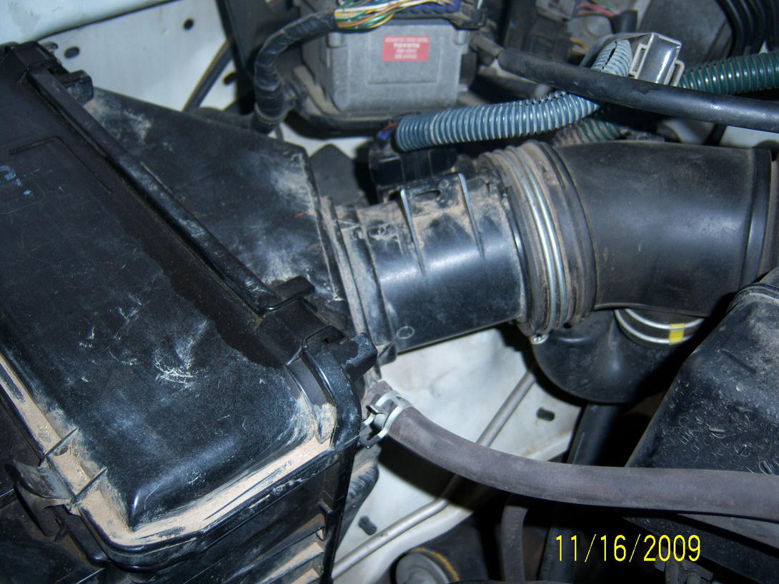

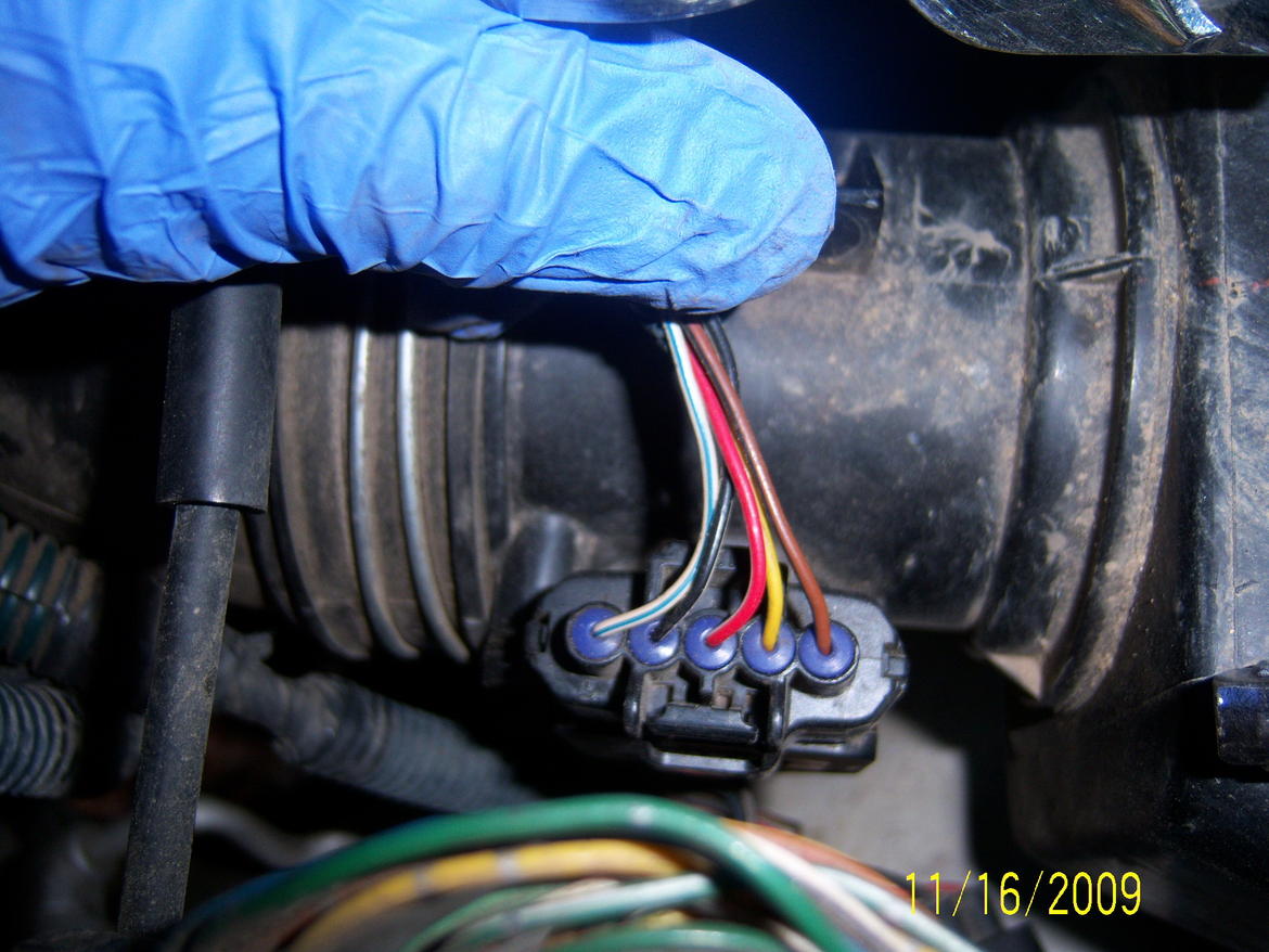

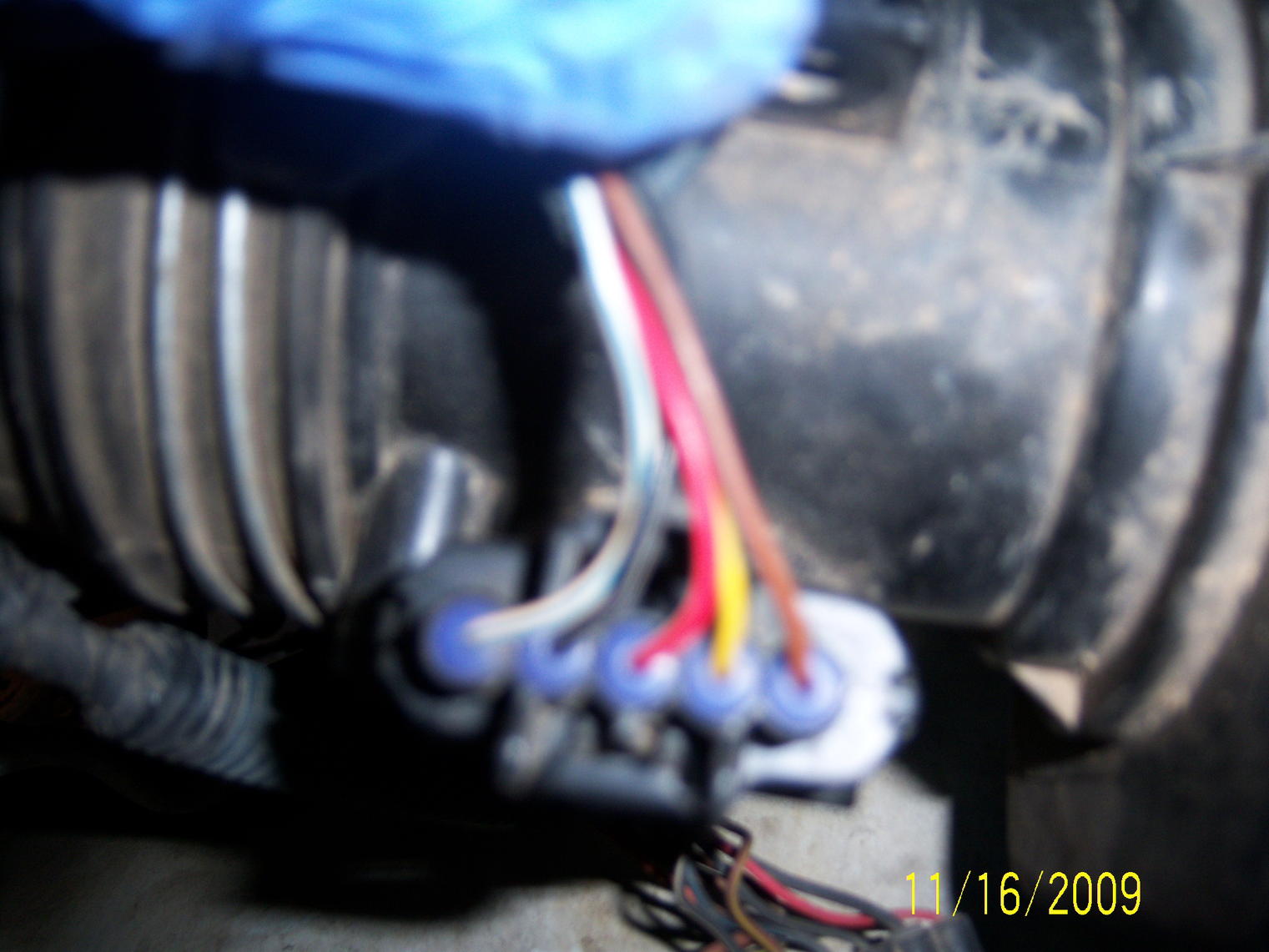

Sorry it took me so long, but I got the pics!! If you notice in the pic, the only wire that stayed put is the white with the blue stripe. Then the others followed in order. Real easy to remove the wires, just get a small screwdriver and pry out the white lock bar, then underneath the shiny metal clips inside, there is a small black tab toward the bottom with the shiny metal on it, its hard to see, just put an even smaller screwdriver in there and sort of press it down. This releases the wire and you can gently pull it out. Install is just find the appropriate spot and gently push the wire back in. If you get resistance you may need to push that little black clip up a bit. Hope this helps.
