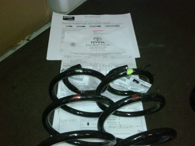

I just got some 99 tall coils for my Wife's 97.

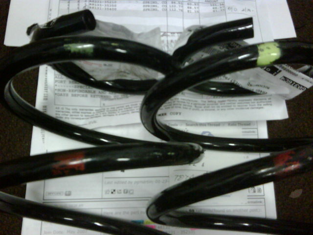

The color code for the rears I thought were supposed to be "yellow and red".
When they came in yesterday, one was "yellow and red" the other "green and red"
Both have the same stock # on the sticker.
Do I have a problem here, or did someone just put the wrong color on the spring? Does it really matter?
The dealership says "don't go by the colors, we don't. Just go by the part # on the sticker"
Thanks for the help!

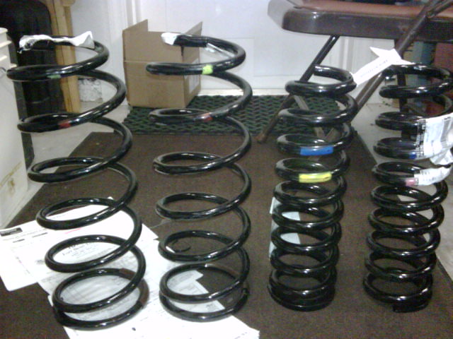

are they the same by visual inspection? part numbers tend to be the way things go, if they have the same number of wraps you should be good to go, as the '99 tall springs are visually taller then other coils, so it's nothing todo with spring rate, just over all height, if they sit level to each other i say throw them in...
fyi this isn't always true with every coil, some coils will actually give you a lift by having a stiffer spring rate and will look visually the same when compared to each other, but when you put them on one will compress more then the other,
i hope that makes sense....
in this case since the 4runner 3rd gen springs all have the same rate visually inspecting them should be fine

I have not measured the heights, but eyeballing them, they look the same ( see the pix ).
