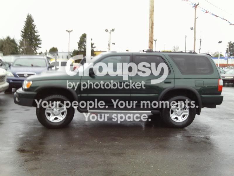

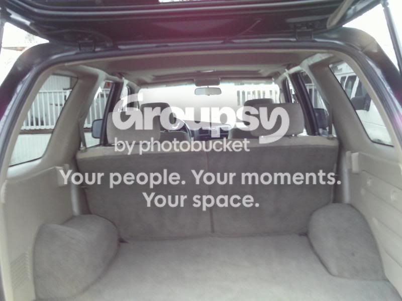

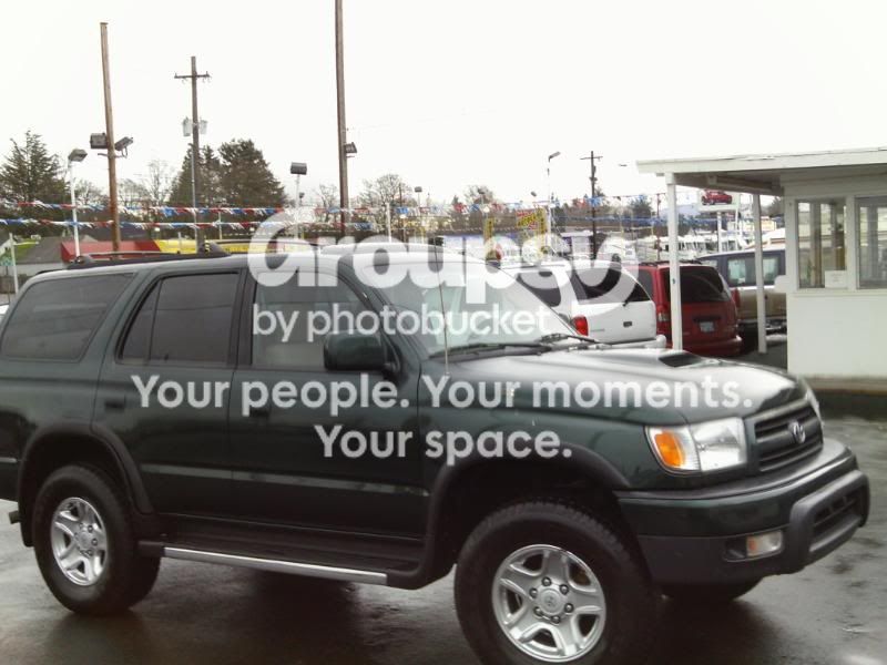

Here are some pictures from the day I got her. These pictures were taken by the dealer I bought it from
001-2.jpg~original
002-2.jpg~original
003-2.jpg~original
004-2.jpg~original
005-2.jpg~original
006-2.jpg~original
007-1.jpg~original
008-2.jpg~original
009-2.jpg~original
