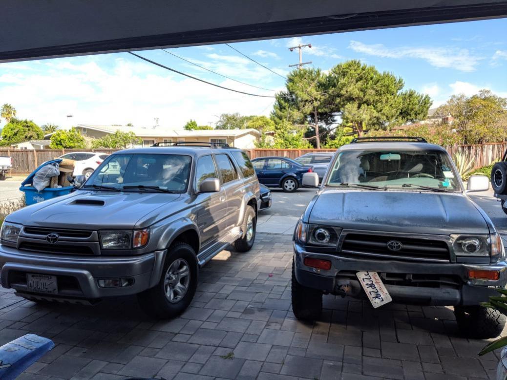

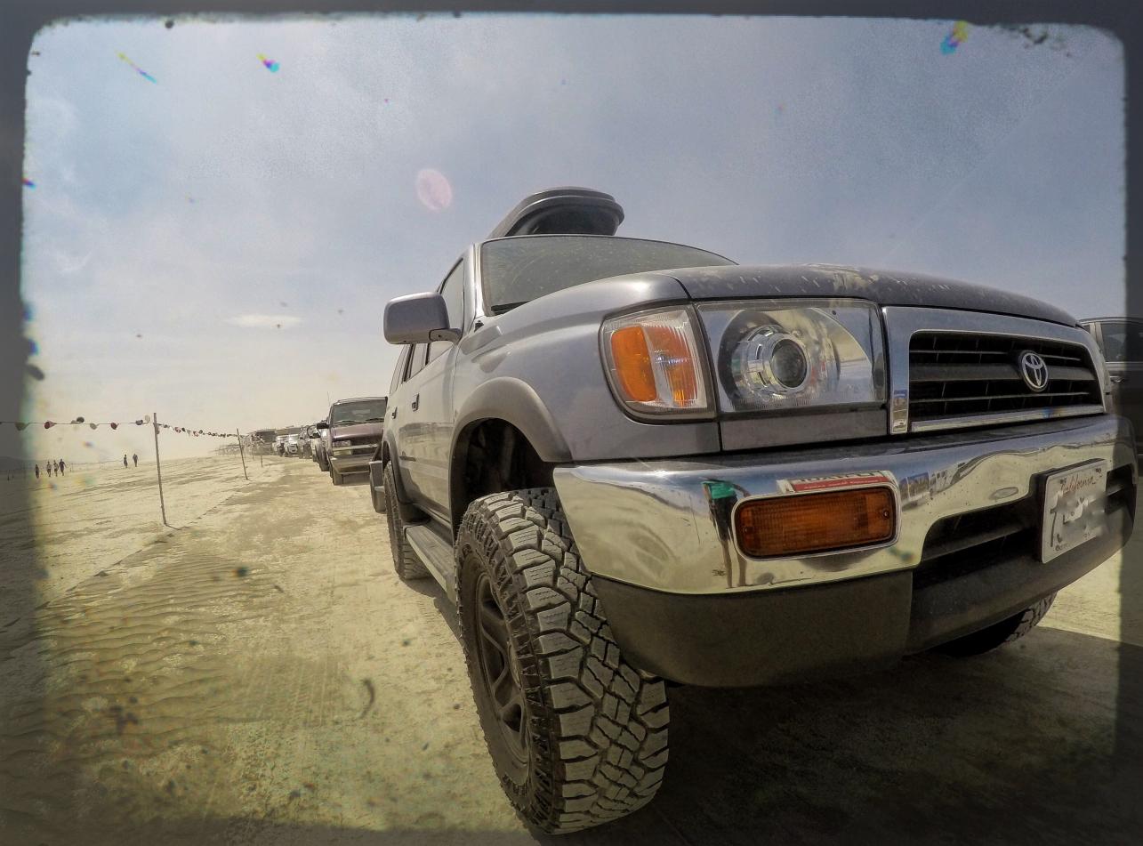

Hey guys Im loving the 2002 Sport Edition! Thanks Optimum! Just a couple quick pics for those who didnt catch them before the CL post was taken down. Not great pics but Im trying to swap the suspension from my old (rear ended) runner to the new one today.
A bit of an issue I could use some help with...
I had these suspension parts on my 1998 SR5:
Tundra TRD Front Coils P/N 48131-AF100 Yellow/Yellow and 48131-AF090 Yellow/Blue
Tundra Front Coil Isolator MONROE P/N 907926
Old Man Emu 906 Rear Springs
Bilstein 5100 Front Shocks P/N 24-188265 (From a TRD Tundra)
Bilstein 5100 Rear Shocks P/N 24-100144 (From a TRD Tundra)

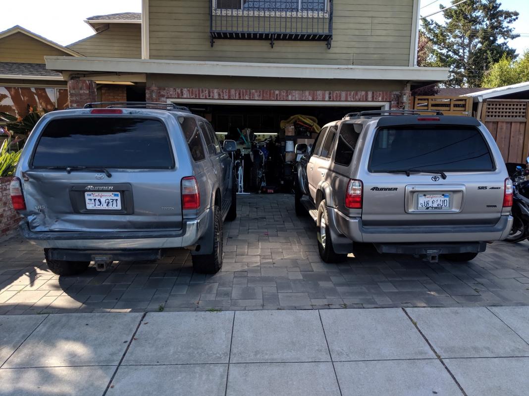

Im moving everything over to the 2002 Sport Edition today and after finishing the front the thing is uneven! The 1998 sat pretty level, or at least level enough for me not to notice. Im pretty picky though and have a good eye (so I think anyway). Im stumped. The 2002 has some rear sag as they do so maybe it'll be a little better after I finish the rear?
Decided to take a break from battling the top nut on the rear struts to ask for ideas on the forum. EDIT: Looks like Im going to have to cut the bilsteins out of the old 4runner. Stripped the allen key from the top and cannot for the life of me get that top nut off. Looks like Im buying new struts after all.
Thoughts?
Is it leaning towards the driver side? Is it possible you mixed the drivers side and passenger side front coils to the wrong side?
Nice new rig by the way!
Thanks for the thought. Its not possible I mixed them up. Ive been doing the swap one corner at a time. I put the drivers side together on both rigs before taking the passenger side apart. EDIT: Yes the driver side is 1/2" lower than the passenger side.
Solid buy. I'm real glad you got this 4Runner.
Is there any way you are able to get a small locking grip plier to hold the shaft as you turn the nut?
When you reinstall it, make sure to coat the threads in antiseize!
Thanks guys. Ended up using an angle grinder to rough the surface of the shaft so that a vice grip would hold. Got the suspension swapped out and am at a shop waiting for them to finish the alignment.
As expected the driver side lean persists after finishing the rear. It is subtle but its there. Wonder if I just let it ride and not worry about. Is there a down side to not doing anything about it?

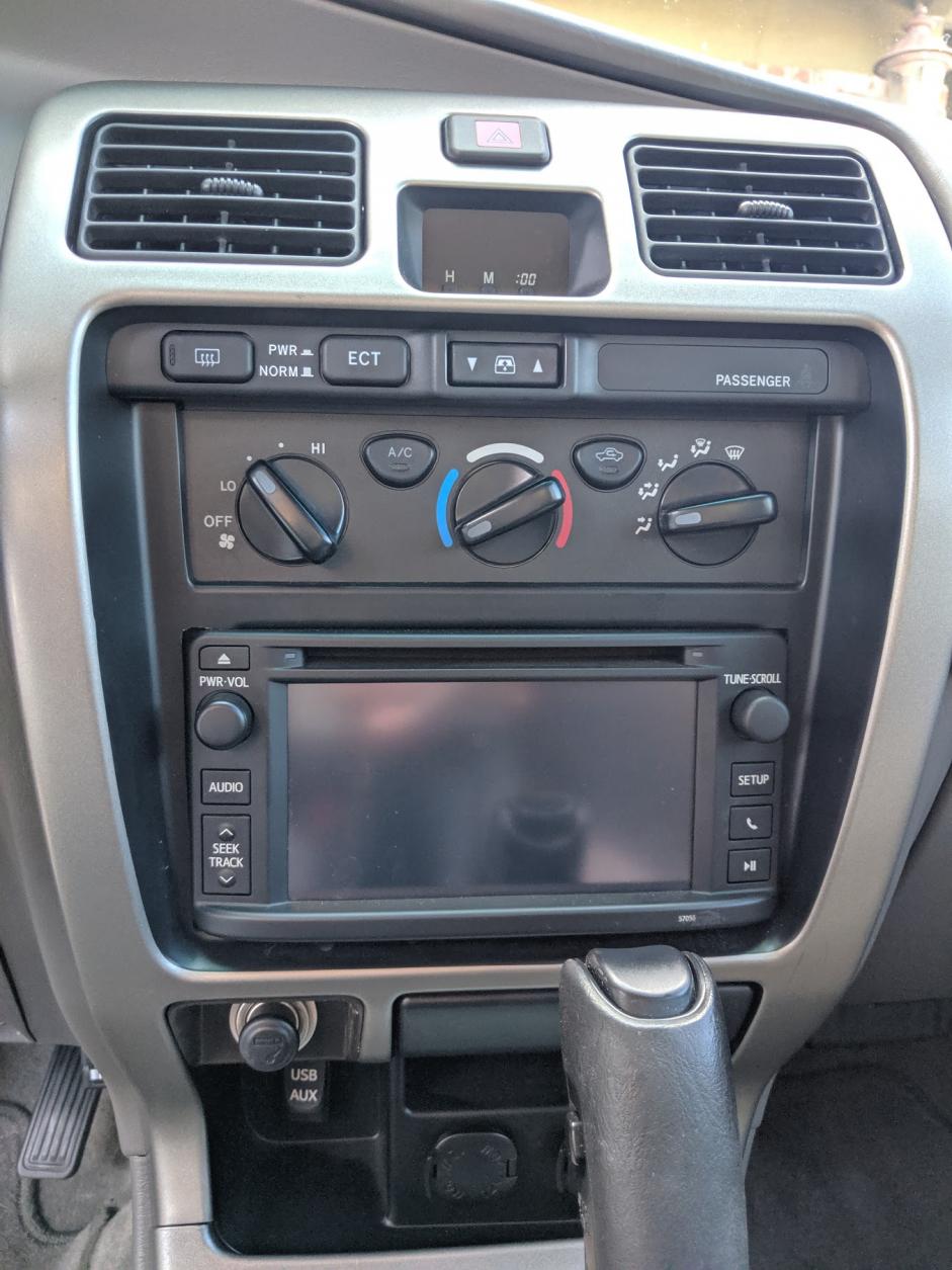

What head unit is that? I habe always wanted to upgrade my stereo but I want a factory looking setup. Whatever that is looks modern and stock. I love it

Lean may settle in. Spring perches seat in well? Also should tighten control arms with rubber bushings when sitting at ride height with weight on springs. If you tighten control arms at droop with rubber bushings can pre load and ride a bit high.

That head unit is from a 2013 Corolla. I agree with you I love the stock look. Im going to sell it soon though if anyone is interested. I've had my heart set on Android auto wireless for a while so I've got a Kenwood head unit on the way from Crutchfield along with a backup camera.
The springs did seat properly. I definitely tightened everything at droop. That's a good point Ill have to see if I can reset and re tighten. Ill probably wait until I transfer over my tundra brakes from the old runner and do it all at once.
