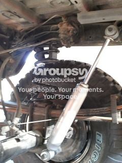

I was pretty happy with the Zuk mod. It was a really easy install, i had to unbolt the rear shackle and use a bottle jack to get enough space between the bump stops to get the coil spring in place. I used a ratchet strap to compress the coil spring as much as possible. I gained 3" of lift, and still had descent flex, and the ride was good. I ran it like that for 2yrs until I got my AllPro Offroad lift for the rear.
^After the AllPro lift.
