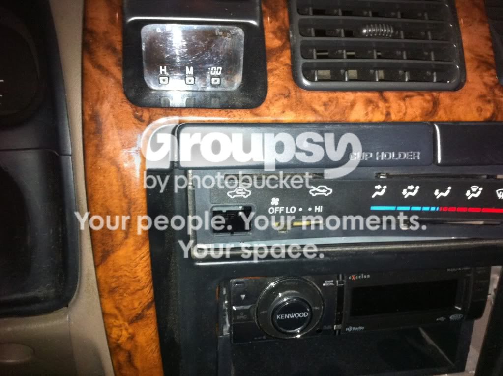

So this weekend, my car was broken into. They stole my sub amp but left my sub...Stole my iPod Cable but left my head unit and faceplate...I don't really care about any of that as much as the A/C button they took in the process of taking my dash apart. :mad:
photo.jpg~original
Its supposed to be 90+ degrees and really humid the next couple days down here in Dallas, TX and was wondering if there was any way to kick on the compressor manually. I went to the stealership and they were going to charge me over 30 bucks for a new one, and they had to order it, so I ordered one off eBay for 10, but it won't be here for a few days and I don't want to get to work drenched in sweat.

Yeah I looked back down into the socket and there's 5 (!) prongs so I don't know which ones to connect to kick it on, if someone knows which two are the actual switch, that'd be awesome.

The compressor should have only one wire running to it. Applying 12V+ will kick the clutch in thus turning on your AC. This does bypass all the saftey measures like the low freon cut off switch but will make it work until you hit a scrap yard. So a fused toggle switch in the dash should do the trick.
I think when you use the defrost, your A/C is on automatically. Just use the defroster and open your vents facing you.

Went up to my car at work, started it and rolled down my window so I could hear, pushed it over to defrost and *click* compressor turns on. Cold air coming out of the side vents.
