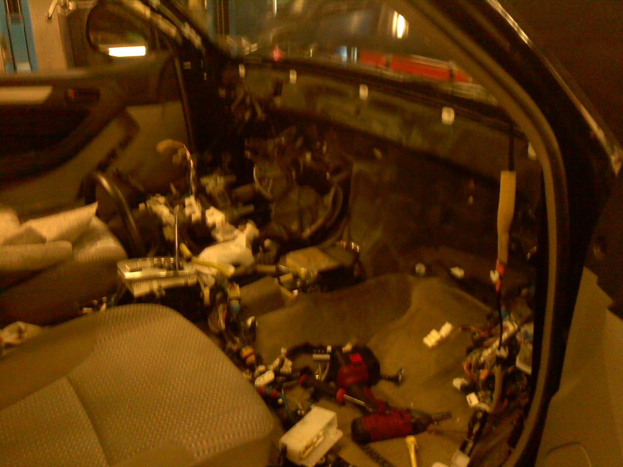

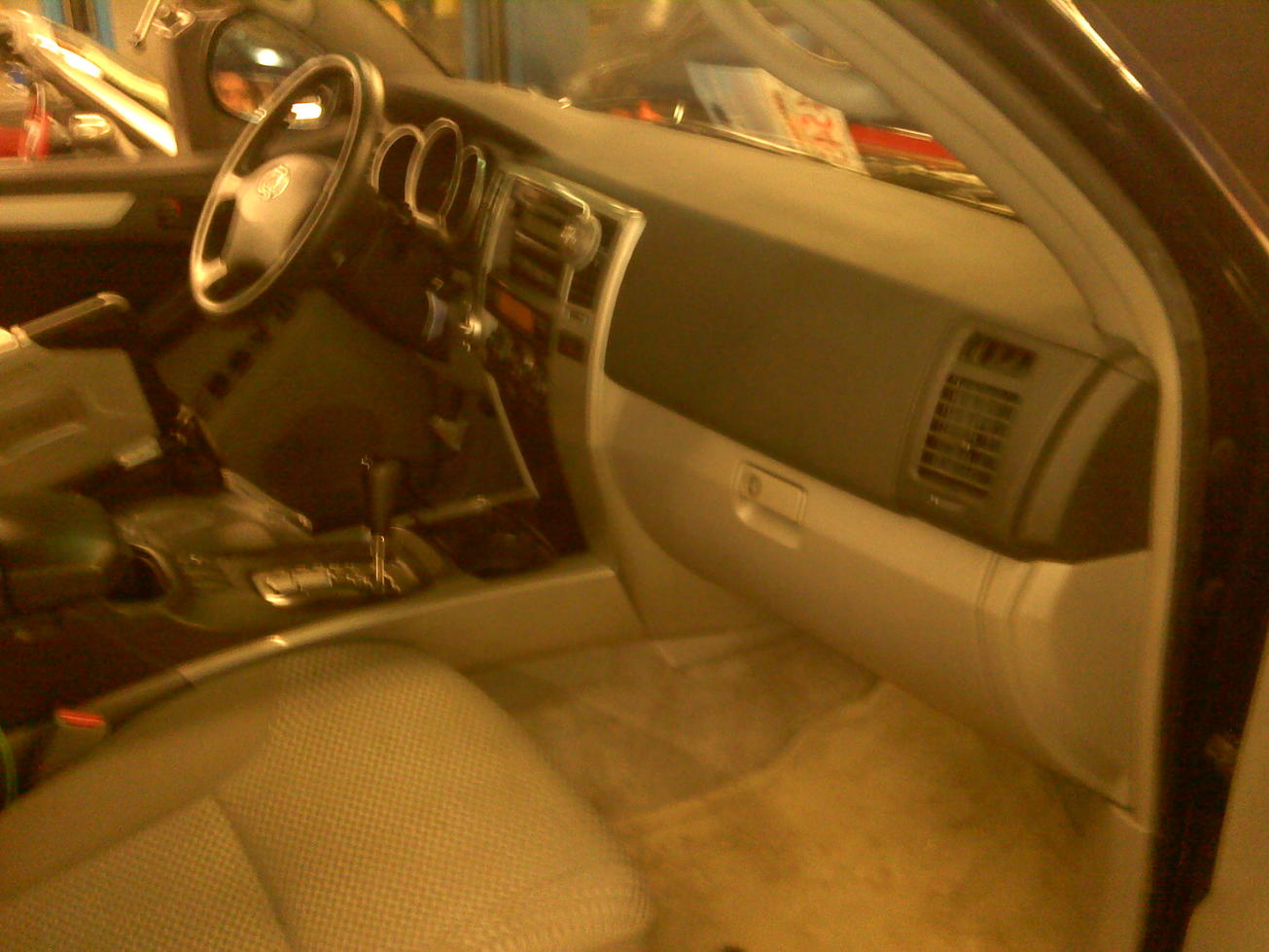

Its a lot of work to get it from the 1st picture to the second with out any rattles or parts left over.
This was an evaporator repair on a 2006 4runner. Crappy part is I get paid only 4 hours for the entire job.

BTW, Mudman, that's exactly what mine looked like the day before yesterday. I nearly crapped my pants when I saw it all laid out like that. Luckily, I had Weathertech digital liners which protected my brand new carpet (which I just installed a month prior) from all of the dirty tools and parts. Fortunately, my mechanic was extremely meticulous when putting it all back together and thus, no hiccups..... so far.

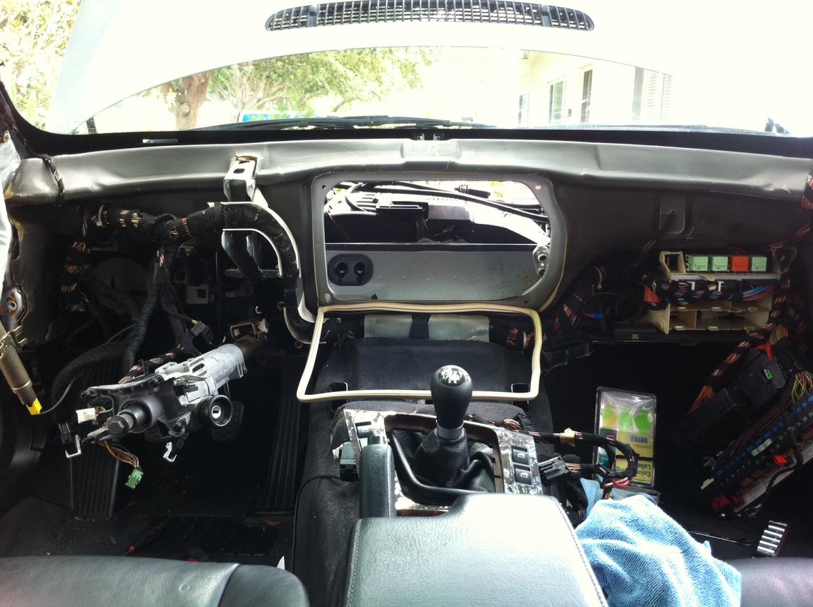

Yeah, evaporators are hard to get to. My dad was quoted over $2k on his E46 BMW, so I took it upon myself and fixed it over a weekend. What a job!

On my dad's BMW, we decided to change the evaporator simply because everything else was tested and determined to function properly. You have no idea how suspenseful the situation was while we waited for the mechanic to refill the AC. Luckily, we made the right decision.
