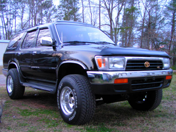

By the way, here's a picture of my "new" ride...

So far the only thing really wrong with it is a missing side moulding on the front passenger door (visible in the picture above), and the antenna has been bent before, and doesn't retract all the way.
