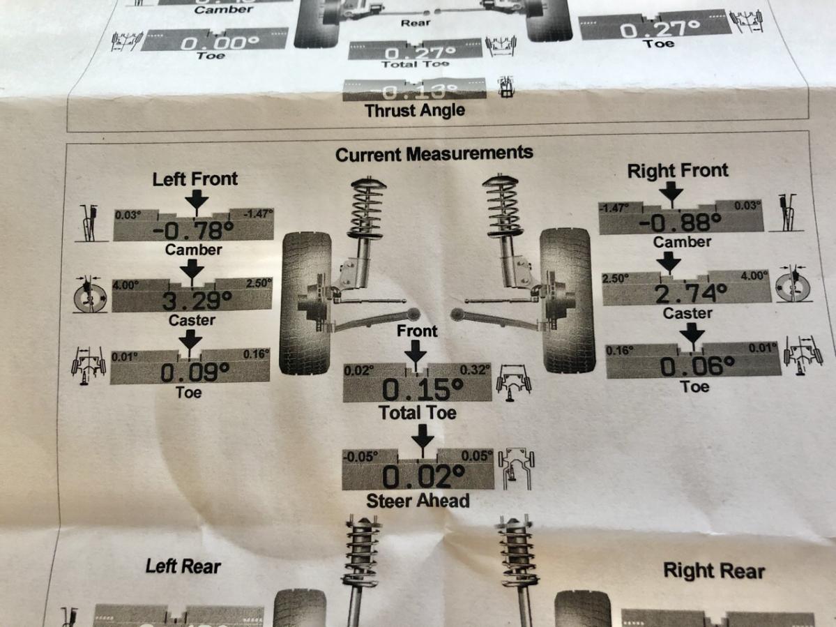

I have a 2.75 inch lift up front with SPC UCA, 285/70 KO2s and 1.25 spidertrax spacers. I also have the BMC chop done so no rubbing.
However after installing the tires, I got an alignment and noticed my caster values at 3.29 and 2.74
I guess my question is, should I ask them to push these to 4? I don’t understand if that’s generally accepted as a better value for caster for these vehicles when lifted or if I should just keep my settings as long as it drives right (which it does)
My only concern is that the wheels do seem pushed back toward the rear more than front. If I still had the body mounts, I’d definitely rub.
I just want the optimal settings. If the suggestion to move to 4 degrees of caster is really just to clear the BMC but offers no other benefit, then maybe I’ll just leave what I have. Should I at least ask them to set caster even left/right? Not sure if the road crown argument is legit. I used my vehicle probably 40% off-road

I was watching the tech fix my alignment specs last week and when it goes to 4 on the caster, it actually goes from green (within spec) to red (out of spec.) They may not have gone as high as possible due to that.

There's nothing inherently "better" about increased caster. Other than body mount clearance, which you've indicated isn't a problem for you, the only thing increased caster would do is MAYBE to enhance the steering's self-centering after a turn. If you're happy with the way it drives, including the self-centering behavior, then there's no reason to bump up caster to 4º or higher except to conform to the common groupthink vehicle modification adage: "If a little is good, a lot must be better."

From my understanding, and I'm no expert, we should see better straight line tracking with a higher caster. Offsetting that, you would feel a little increased pressure required to steer.
Most lifted 4Runners with aftermarket UCAs and larger 285/70 tires will be running castor at or near 4 degrees.

There are in fact positive driving characteristics to more caster.
I got sick of having white knuckes after every road trip.
4.5 * and its like a different car. Can relax on drives now...way better.
