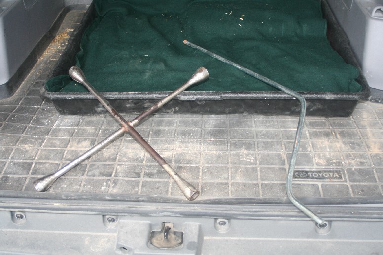

Here are 2 extra tools I carry. The 4-pt lug nut star is an antique I've had since my first car. The spare winch wrench is home made.
A good shop will teach the tire techs (kids) to only use an impact to run the nuts up, then finish the job with a torque wrench. If the shop can't handle these basics then take your business elsewhere. ALWAYS use a torque wrench on lug nuts (and retorque after 100+ miles), especially on aluminum wheels.
