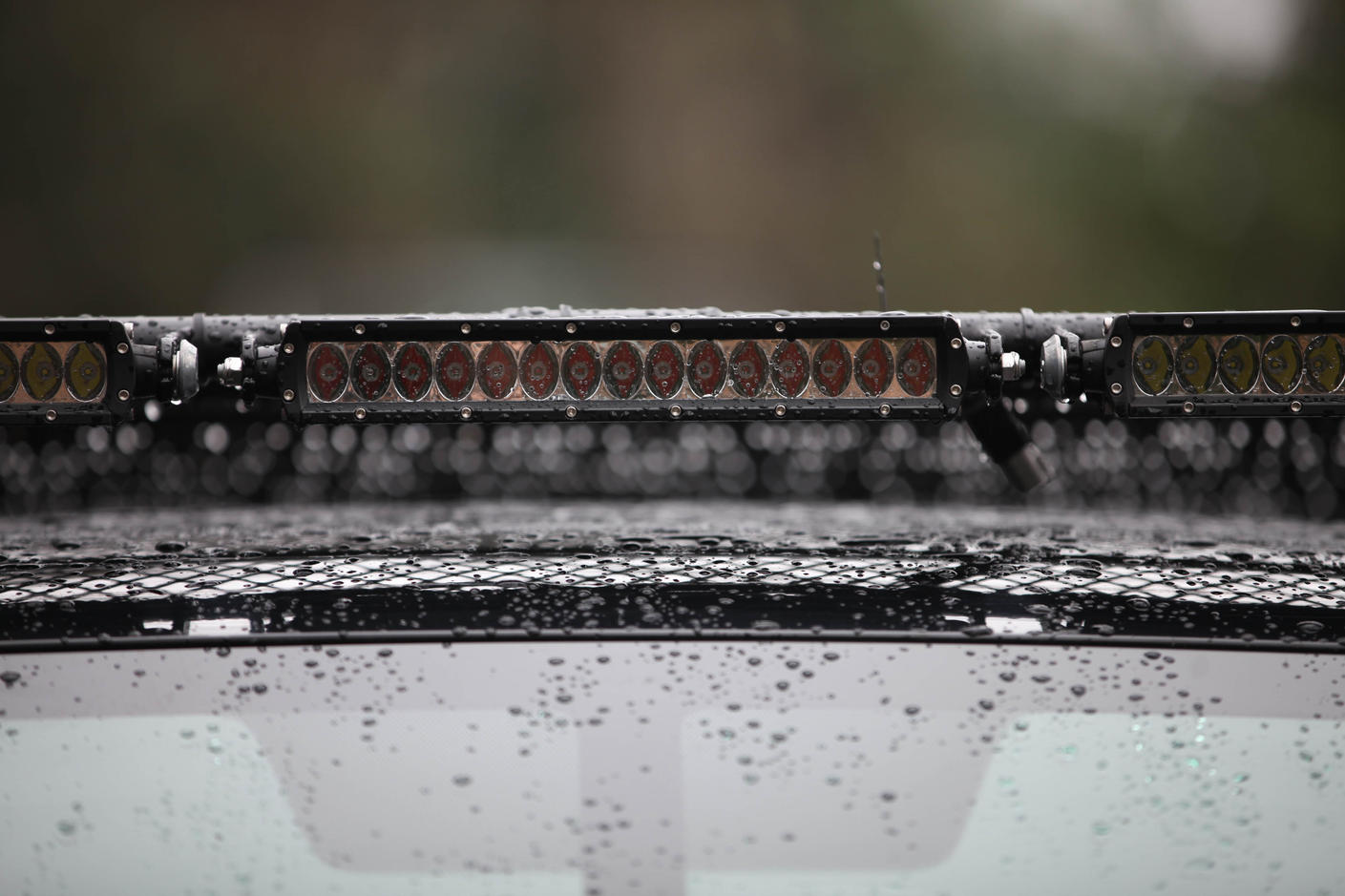

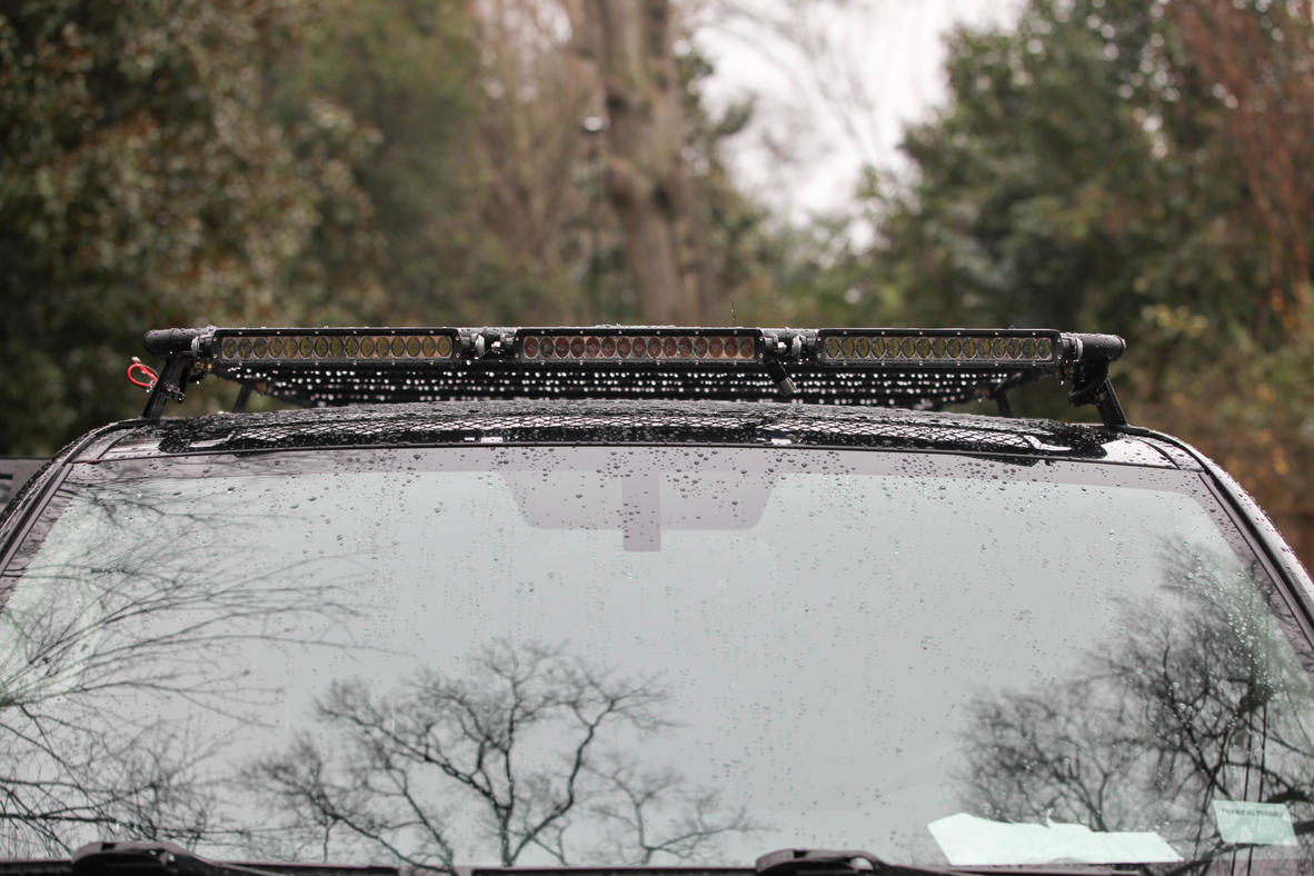

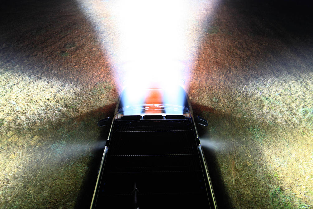

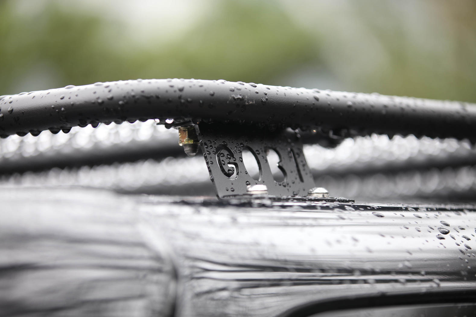

So heres the new GOBI rack Mebe4running style.... Its basically the stealth rack just without the top bar. More pic's to come....

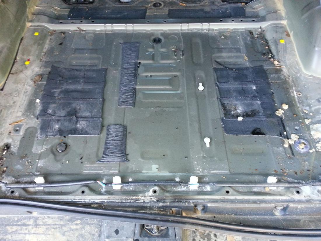

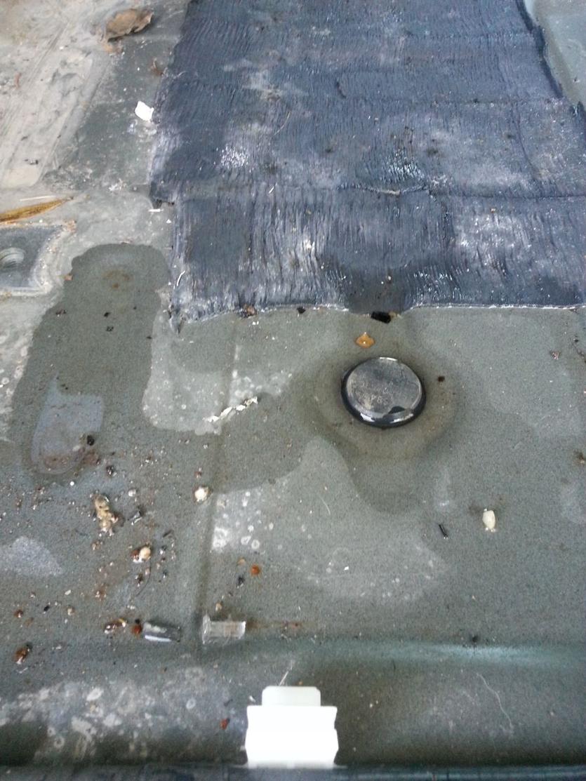

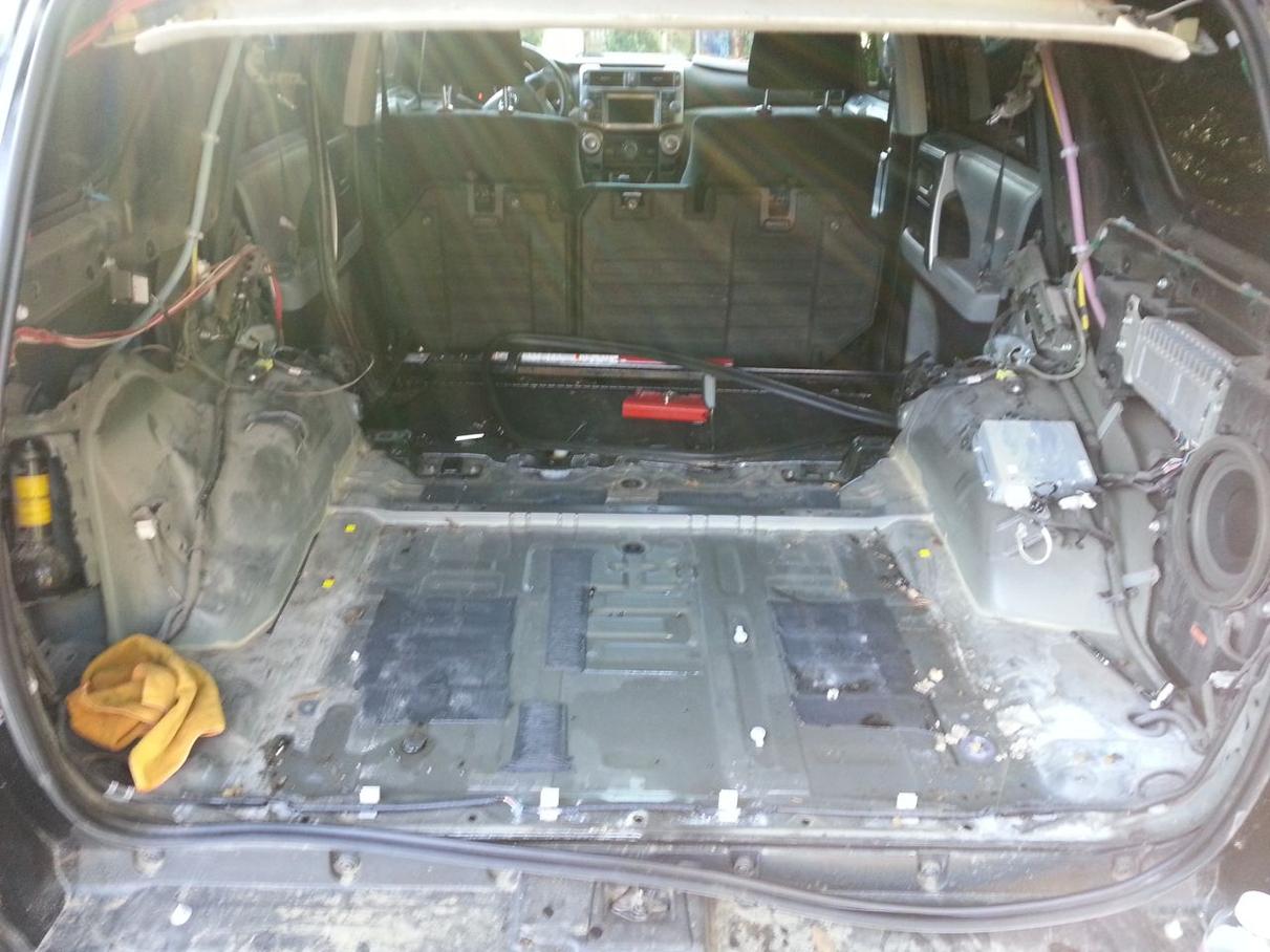

Well, here down south y'all we have been having a lot of rain! In fact three straight days of it! It finally stopped this morning. I went to open the rear hatch of the door to find.... go on, guess? Yep, that's right water; how much? Enough to cause mold issues down the line in the future that's for sure. Problem occurred as a result of an aftermarket install which I only have myself to blame! The first source of the leak was from the the rear hatch door grommet that holds the wiring for the rear window, wiper, door lights, speakers etc... I tapped into this with my rigid light wiring and left a hole clearly big enough for water to seep in. The second source is still to be determined. I believe it entered through the white ventilation covers we have either side of our trucks on lower side of the bumper as it was wet around those areas. However I'm still determining whether or not that was the actual source.

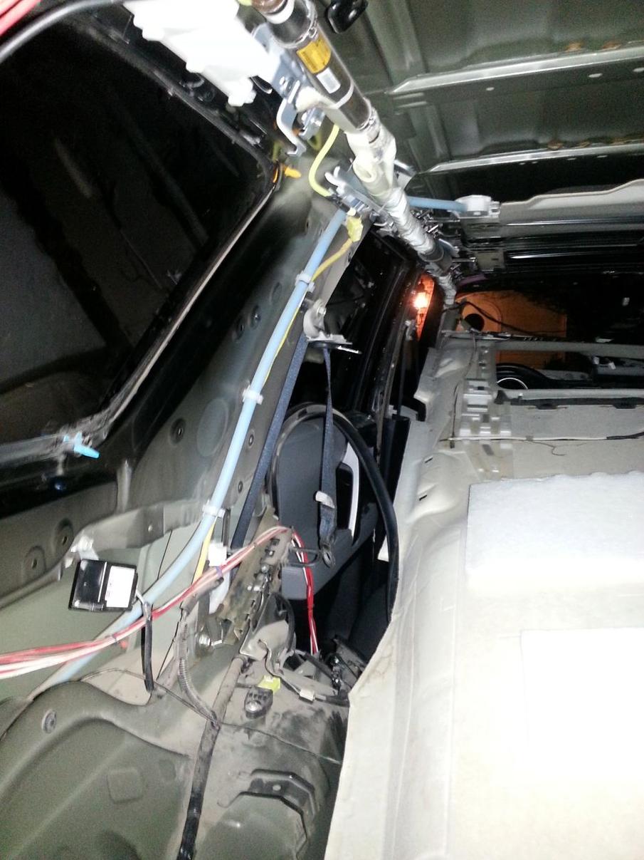

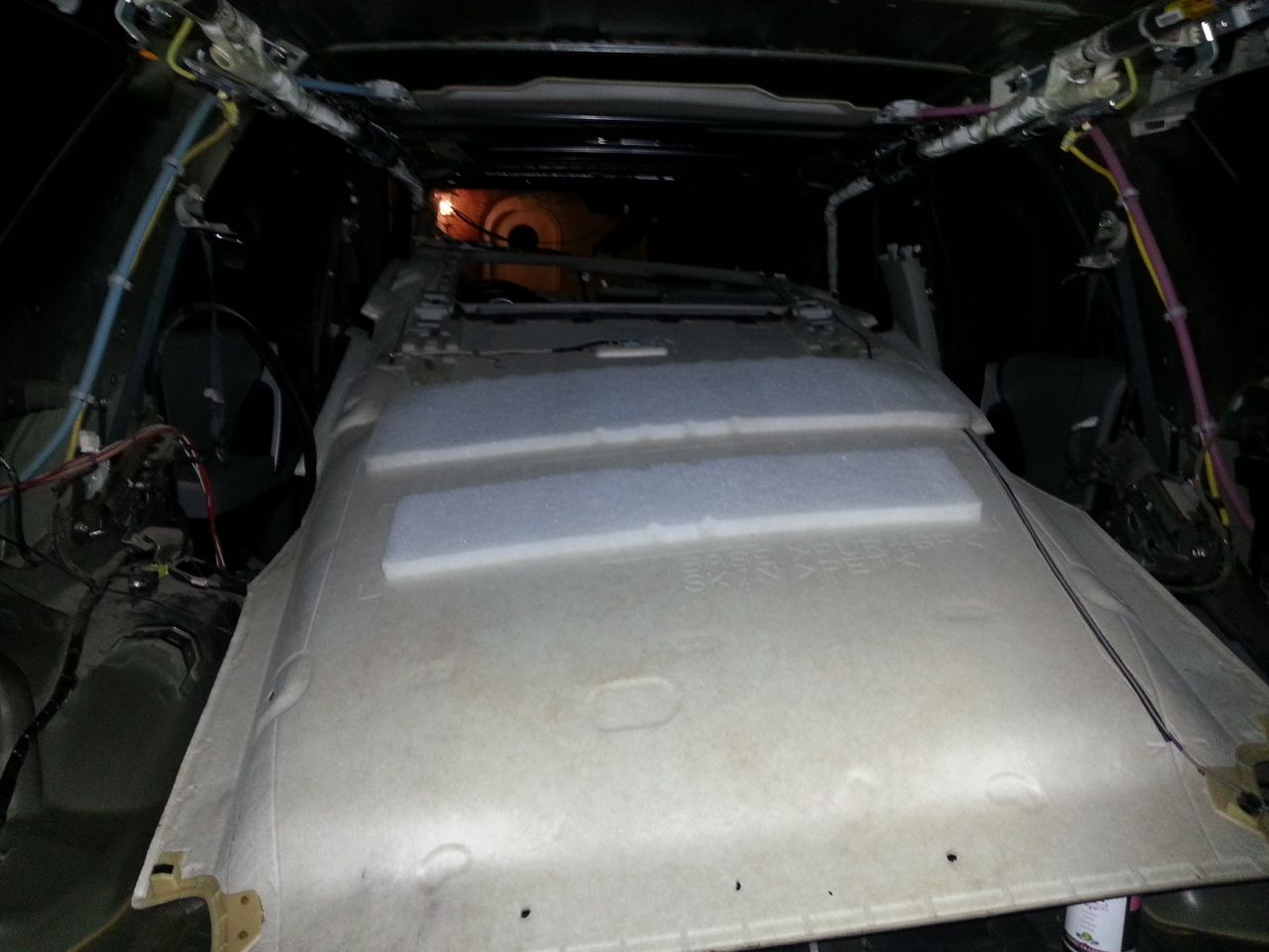

Well the break down has begun.... I'm taking the interior liner out to dry (*need help with the last bit HARPER7?:hail:) and have removed the carpet etc.... It's actually a blessing in:spy:. It is a good chance for me to clean up some wiring and install some sound deadening, which I have been meaning to do for quite sometime.
So got my weekend cut out for me!
**Question for Harper7 or anyone else who has removed their interior liner. What is the best way to disconnect the left interior, a-pillar? I simply wish to reach the two wire harness's for the side curtain airbags and disconnect them. They are both located behind the pillar about half way down. This part is the only part that has stopped my from taking the liner completely out . I'm hesitant because what is stopping me is that black plastic tie, near the top. It look's to be be designed almost if its only meant to be broken in the event of a crash!? So I have left it be until I gather some solid research. Do you happen to know? Would really appreciate any feedback or suggestion!**
