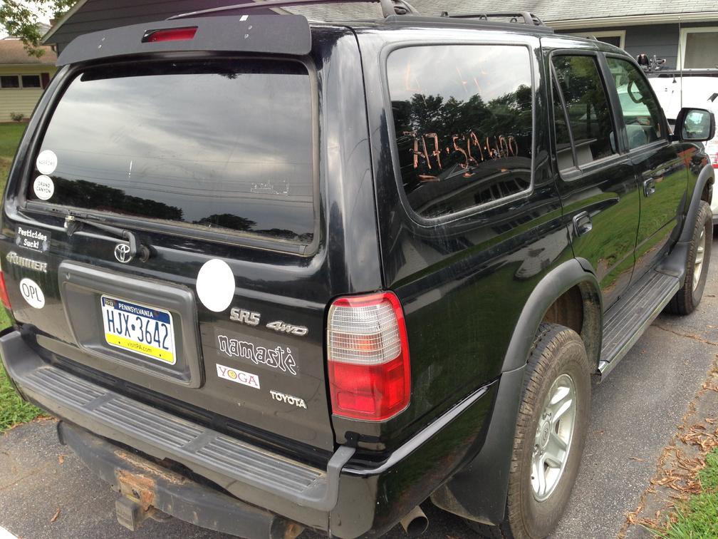

Bought a black '99 SR5 about 2.5 years ago as a low cost, dependable second vehicle to drive the 3 miles to work, tow firewood, and take on weekend trips to the woods here and there. The 4Runner was a Craigslist find, and got it for $4k with 145k mi on it from a shoeless hippy leasing a small electricity-free house in PA's Amish country. I thought I got a decent deal on the thing, despite the fact that it was filthy inside and out and needed an immediate timing belt/water pump/coolant flush/tranny flush/plugs/wires/fuel filter/air filter/disinfection.
As purchased - namaste!
I bought the Runner while in grad school, with the corresponding grad school budget. So even though I longed to lift/tires/armor this thing I was able to talk myself out of it because I live in the Mid-Atlantic and use for those mods would be limited (but it would look so good ...). But now my wife is out of grad school, so our budget isn't as tight as it once was, so mods have crept back into my viewfinder.
Weekend getaway in WV last October
Currently it sits much the same as it did 3 weeks after I bought it. But, it's wracked up 15k more miles and aged some, too. The current situation (and approximate cost to remedy) is this -

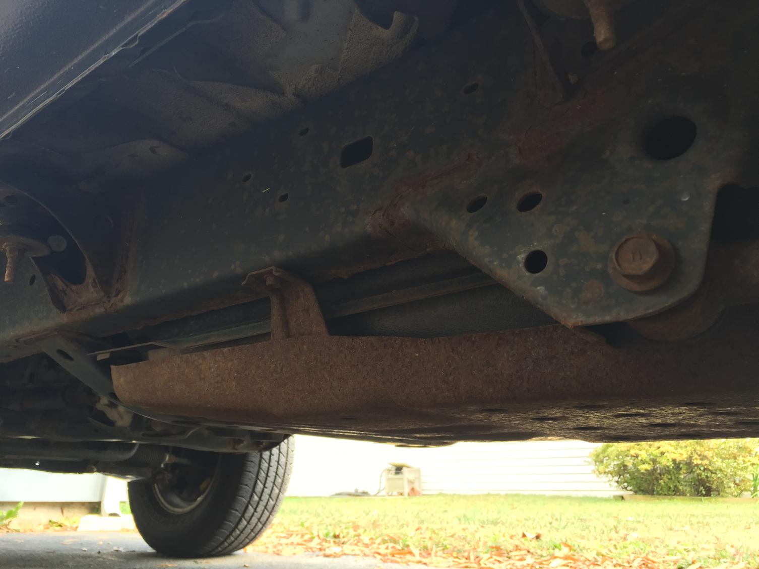

8. Front and rear bumpers with some rust and some more rust on the frame (but nothing too crazy) [$1300]

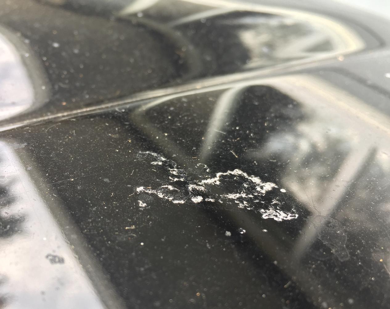

Driver side
9. Pitted and etched clear coat due to PO lack of hygiene [?? I tried using ScratchX to fix, and it helped, but still needs more work to restore original shine, and I kind of think it may never happen with this paint job...)
Example of etching
