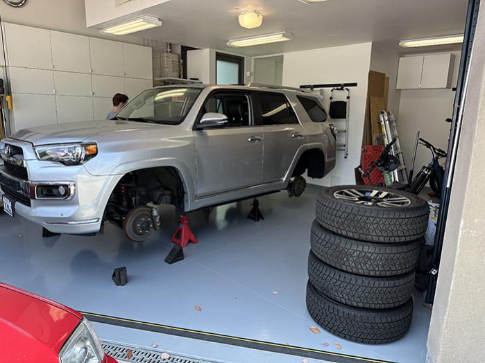

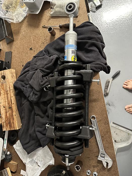

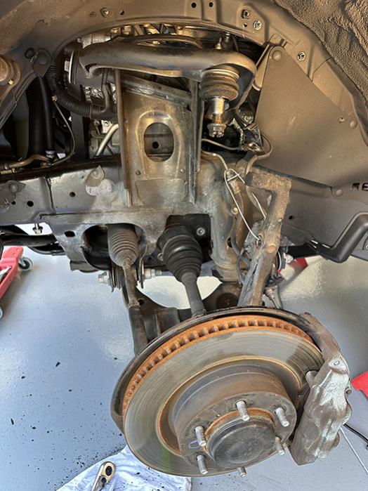

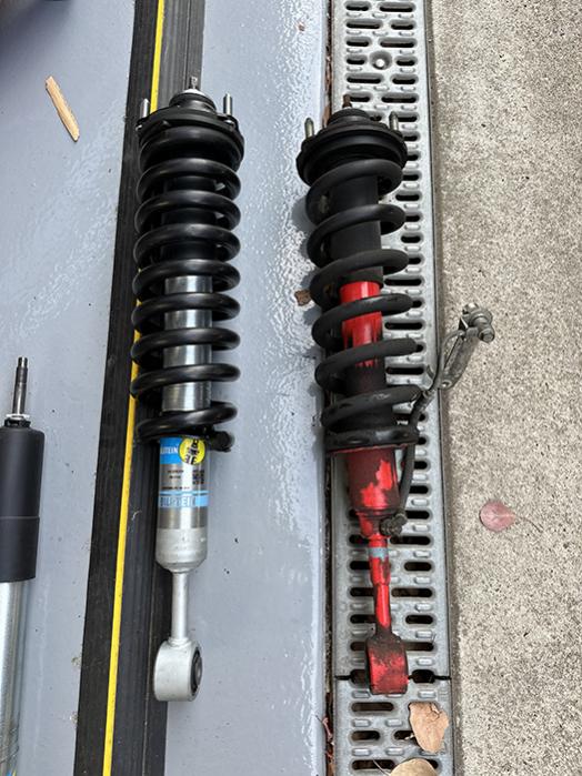

Update - I completed the x-reas delete over a weekend by myself with the occasional assist from a kid for things like dropping the skid plate. If you're mechanically inclined it is very easy, really just labor. If you keep your springs, you will need to loan a spring compressor from your local auto store, but it's no big deal.
I opted for the Bilstein 5100 shocks all round, and kept the existing springs. 4WD shops want you to get much beefier shocks (like 6112s up front), but Bilstein recommends the 4600s as an option, so the 5100s are already a high quality step up from those for a mostly road-going truck. There is ride height adjustment on the fronts, but I opted for the stock position, since my daughter is short! I thought I posted a how-to, but clearly not!
Ride-wise, the 5100s are fantastic. The truck feels like it rides better than it did before, and my x-reas was only weeping a bit, so I'm assuming I had close to the original ride feel before the swap out. I was worried about "brake dive", but there doesn't seem to be any of that. Likewise body roll, that seems about the same. Overall, I'm extremely happy, it feels like a new truck.

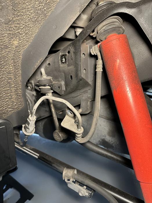

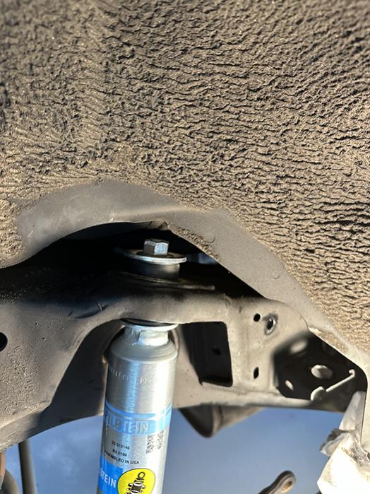

The top nut on the rear shocks cannot be reached by a torque wrench, so you'll have to guesstimate that one. Everything else can though.

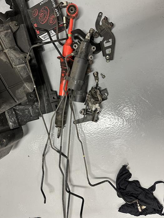

Removing all the old pipes etc is a lot of the labor, but for me, I didn't want to leave all that old junk on the truck. I wanted it to feel crispy new like it cam from the factory with SR5 suspension.

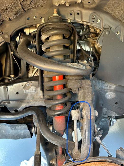

Another thing I thought of. While I had it all apart I replaced the sway bar end links and a ton of little plastic plugs in the plastic skid plate splash guard and some missing rubber fender splash guards too. Not needed, just worth spend a small amount more while doing all that labor.
OK, hopefully this works, here are some of my photos, including the spring compression and the difficult to reach (with a torque wrench) rear top nut.

My only suggestion, after have done it 2 or 3 times, is to forget about a spring compressor and use the floor jack under the lower control arm to compress the spring, remove the single top nut securing the front shock and the spring and shock come out disassembled. Reassembly is just the reverse procedure. Saves a lot of time with spring compressor and possible danger.
Great tip, thanks [MENTION=101325]rdruss[/MENTION]. That would for sure be faster. I took the springs out for the following reasons:
  • I wanted to replace the upper rubber spring mounts as they wear out and replacing them really helps ride quality.
  • I also wanted to see if the springs were worn out, and if not, to fully degrease them and the surrounding area because leaking x-reas creates a mess.
  • Using a good spring compressor is pretty simple and safe as long as the right precautions are taken. I used a ratchet strap (not shown in photo!) to my workbench so if it slipped, it had limited scope to travel.
