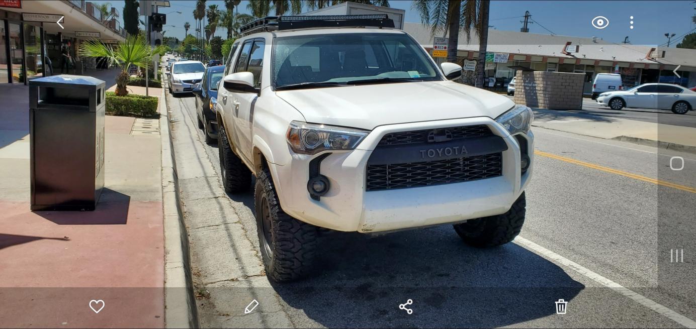

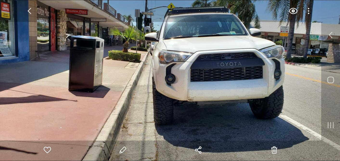

I'm running -10 with 4.1" back space and have 305/70/17. I'm more than happy with the performance and appearance. I also have an aggressive body mount chop due to the wide tire. I would not get a -38 as others have mentioned.
Can you post a pic?
here's one from the front. I don't have one from the side at the moment, I can upload one on friday. I just don't take enough pictures sadly. regardless you can see even with an 8" wheel and -10 offset with the 12.25" wide tire they do not stick out. if you have a 285/70 it would be even narrower.
