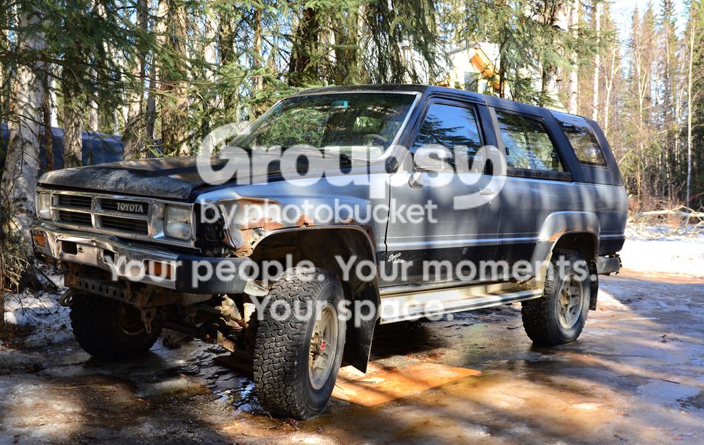

A rusty and battered '89 1st gen
lledwod
Hi fellow enthusiasts. Here is my 1989 'special edition' 22re 5spd 1st gen.

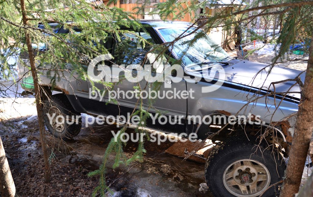

I purchased this truck a couple months ago, and am going to try to make it into a presentable daily driver.

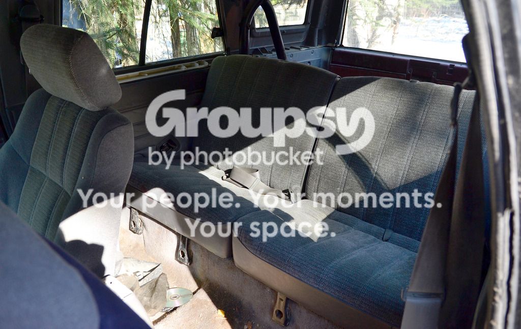

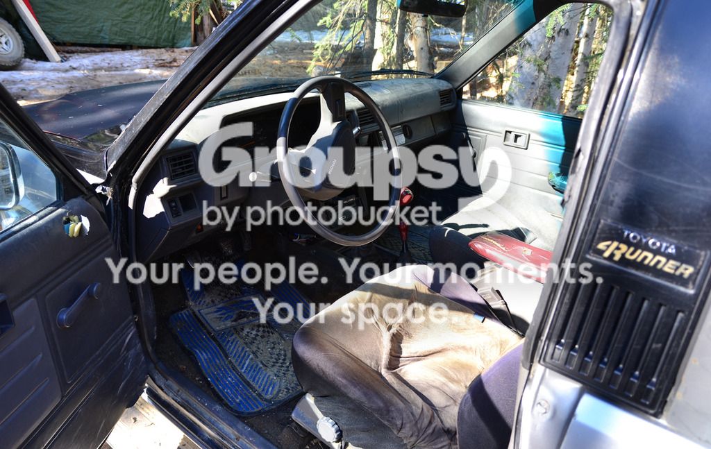

- the interior is OK, salvageable I think.

- the body!

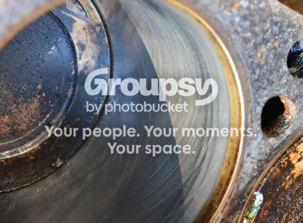

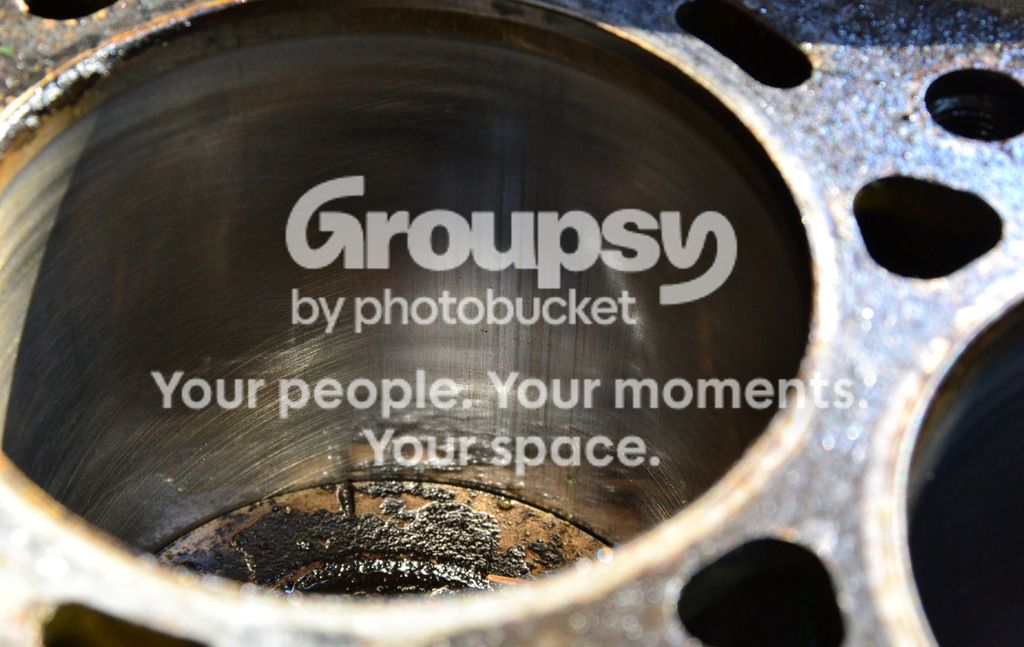

So this 'runner has 338 000 km's, which I guess isn't too bad, about 210 000 miles. I've got a couple of photo's here of the cylinders, I think they'll be fine, but I am curious to hear some feed back on them.

I am pretty comfortable around toyota's, my daily drivers for the past 21 years have been 1st gen pick-ups. I've done ALL the work on them, including a few engine overhauls and a couple tranny overhauls, myself. I've also owned a couple 2nd gen 4runners.
Now I have a dog, a wife and a baby girl, so we're growing out of the single cab pick-up!
Is it worth trying to fix this baby up?!

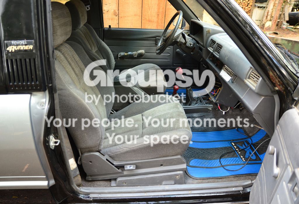

So I've been picking away at the 4runner all summer. The engine came out; I checked the rod bearings and didn't look so hot! I plan to rebuild this engine. In the mean time I have dropped in the engine out of my parts truck. I've also been through the suspension and steering in the front, replacing upper ball joints, idler arm, CV's, brakes, 'rebuilding the freewheel hubs, repacking the bearings etc. I pulled out all the carpet and washed. It looked terrible, and came out far better than I expected.
[/URL]~original[/IMG]
I am putting the interior back together, and trying to piece together the exterior bumper/trim/lights/etc.

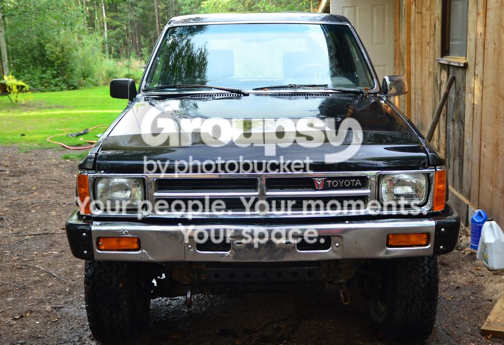

First time I did an engine with the hood on. There was enough room. I used a gasket from a carbed manifold, and ended up sucking coolant into a cylinder. Not much, but enough to get the exhaust a little white after a minute of running. So I am waiting on an OEM gasket.
The rear window works when powered directly, but not through the switches. So I'll be looking into that.
I've started patching up the 'holes' (rust). Don't worry, I'm not trying to kid myself, I'm not expecting a show truck!! I really just wanted to prevent some of the road dust from getting in the cabin. Also I've never played with bondo and I figured this would be a good guinea pig. I would like, if I have the time and money, to straighten it all out with fiberglass panels in the future. If it turns out to be a solid truck. I am also trying to get a stereo wired into it at the moment. I have spent a lot of time fabbing broken parts together, I've really got a lot of junky parts to work with :( Spot the custom touch in the 3rd picture?

Yea, I might look into doing something about that A-pillar rust!. Any suggestions? Grind out the rust, bondo and paint?!
Otherwise, I figure about another week and it should be 'on the road'. I took it for a good hard run a couple days ago and everything seemed fine, except the tires need to be balanced (the PO had new tires installed, but probably they weren't balanced, as there are no weights on any of the rims).
