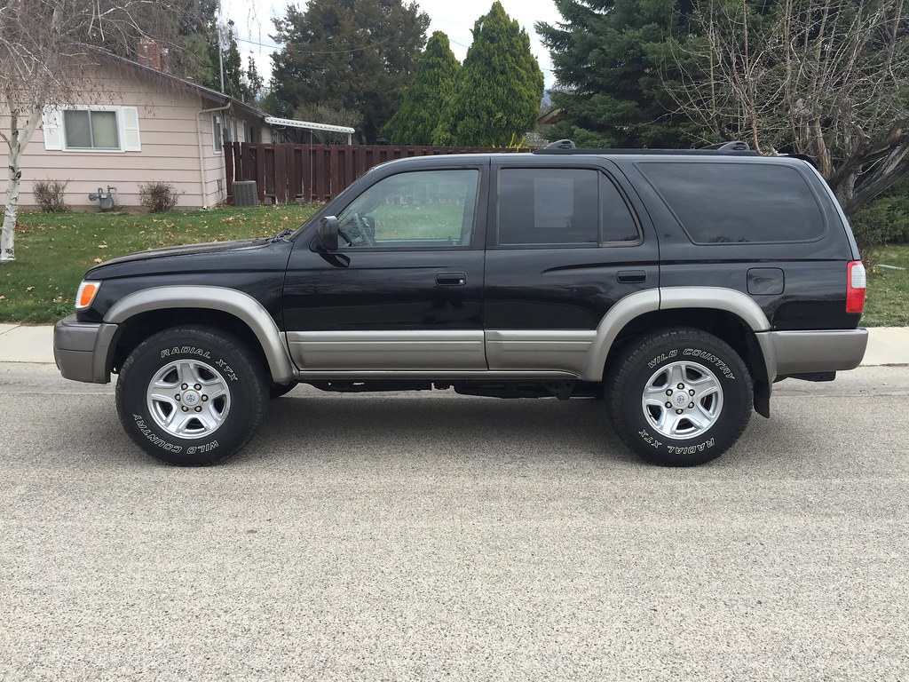

I've been looking at 3rd gen 4 runners for about 6 months now and this one has been up locally for about 3 weeks. It's a 2000 Limited with 151,000 miles, locking diff 4x4, one owner. Everything works that I could tell, AC blows cold. The dealer is asking $7500 which seems to be high book value. But most 4runners/tacoma demand a premium here in Idaho. The only real blemish is the hood and passenger fender seems have been hit at some point and repaired. Not a super big deal to me.

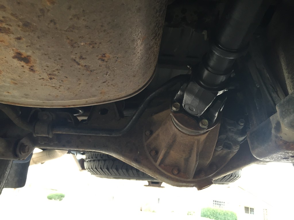

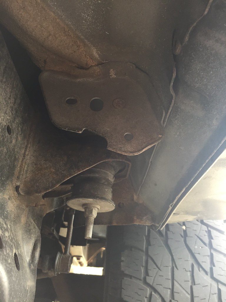

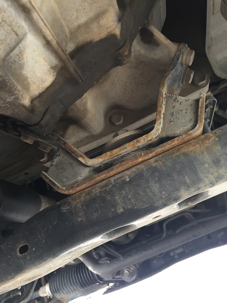

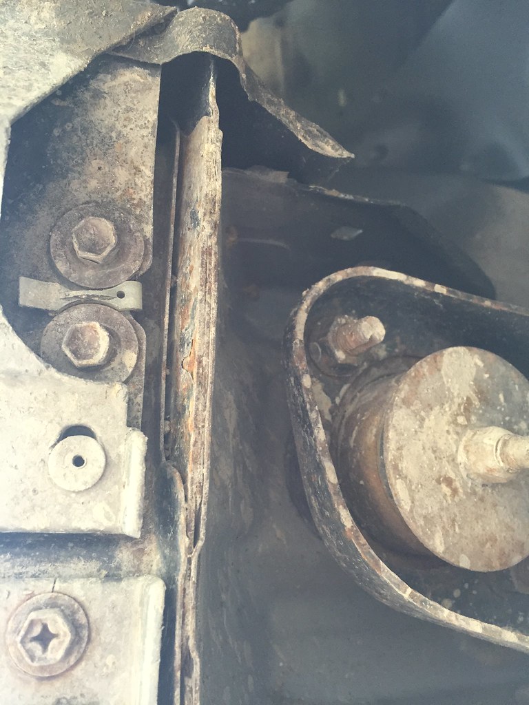

Here are some photos. Including the underside, any input would be great. Anything that looks concerning? There is a little oil on the motor, but nothing that seemed excessive. Same with under the truck, some by the rack, but not covered like my BMW :whipping2

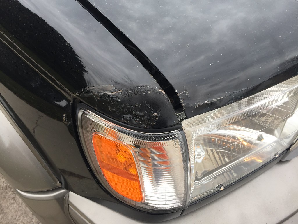

Not sure what's going on here...

It looks like that drive shaft is new or painted or something

I think the drive shaft was new. It had a sticker on it, and was not dirty and didn't appear painted.

Just my opinion, but the panel gaps in the hood and passenger area look like a total mess. That was not repaired properly.

I had the hood pop'd. So the hood was up and makes the gap appear larger than it is. With the hood closed the gap seemed normal. I don't think it was actually repaired. I think it's just damage from being hit and not repaired.

That explains that. Still, that corner lens doesn't look like it's sitting flush.
Looks like the rear driveshaft has recently been worked on, a new rear u joint and a rebalance is my best guess, seems to be a sore spot on these trucks as far as a source of vibration.
Me personally, I walk away from anything that's been hit, anywhere on the body, unless it's some totally cheap beater. The repair looks really shoddy IMO.
I'd also check what that moist spot on the steering rack is.
Rust-wise the truck looks pretty darn good. It's "honestly" presented in that there isn't a cheap coat of black rustoleum or rubberized undercoating over everything.
