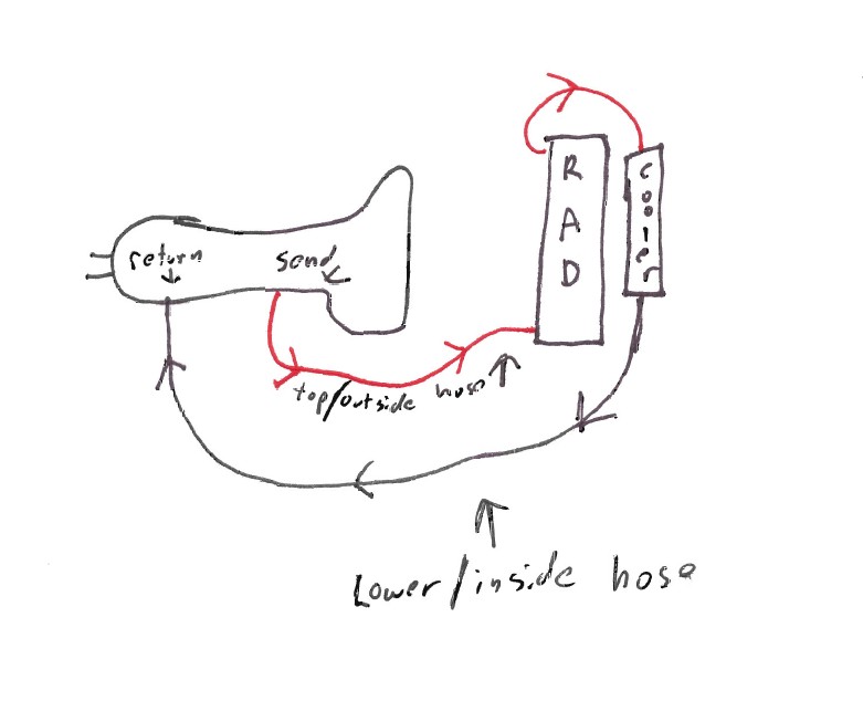

Is the trans cooler as close to the rad as possible?
I've attached a drawing showing how my lines are routed.
Mine cools well.
It looks like it was drawn by a 3 year old but no, it was done by me.

Edit - I hadn't seen the posts after the brake question. RE: The drawing....I like it. Do you not have an AC condenser between the AT cooler and the radiator, tho?
