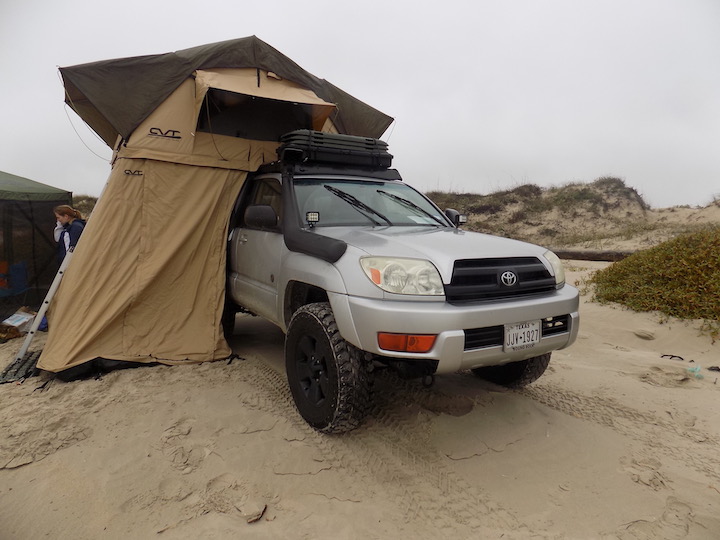

note: This was at Padre Island National Seashore on the South Texas Coast. Temps were in the high 40's today on the beach.
