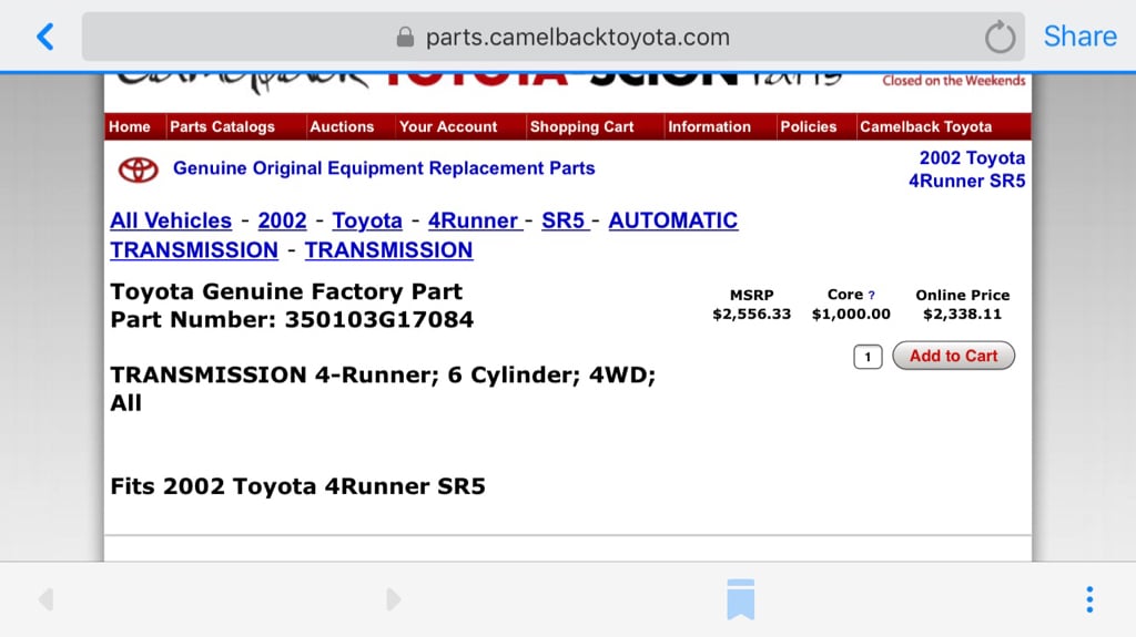

I've found donor trans for 01-02 for cheap, but FWIW a factory reman is $2,395 through Toyota.

Additionally the link and part # provided by Timmy the Toolman was a Factory Rebuilt Tranny. This is as good as it will get. If a used unit is $1100 and a factory rebuilt unit is $2500, it’s easy to know the right path to take.
