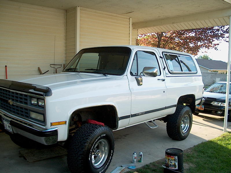

Also, I meant to include this in the original post, but my last 4x4 (had a 97 2wd 4runner and a Mustang between them) was a 90 GMC with 6" lift and 35's, it's my inspiration for the 4runner. Won't be as extreme, but definitely what I'm going towards.

Like the chevy we have has some similar vehicles,..
