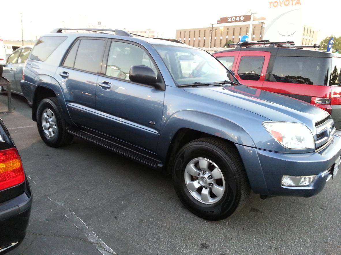

Picture attached, thanks again for everyone's help!

ABSOLUTELY. Already done, had the dealership pull maintenance records before I went down to Long Beach to pick it up, they couldn't find record of replacement, so I had them do it before I made the trip. Last thing I want is a destroyed engine block!!
Thanks! Yeah, couldn't be happier with the thing. I've owned quite a few different vehicles, and never been as impressed with the build quality as I was after just three hours of driving it home (And it has 100k mi. on the odometer). It is very obvious that it's a solid, smooth, well engineered and put together machine. Pretty sold on Toyota at this point, first I've ever owned, or at least Toyota trucks/SUVs. Apparently they're pretty hardcore about how they make these: Tahara plant - Wikipedia, the free encyclopedia
