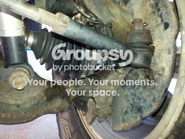

Sorry, I updated my model specifications. I will get a hold of the scanner as soon as I can to check on what you're saying. My question in the mean time is why would the system gradually start to improve to where it is now? Could it be that the continuity of the wire we used to fix it is not giving off a proper value? I was installing my rear differential while it was being installed also so I know he didn't know to be careful with the wire. I have low knowledge of the CV install components but I was told there's something on the CV that the ABS is reading? This is also the first system to have not only a speed reading but an angle sensor as well? If so could riding with a loose CV bolt caused any damage to whatever the sensor is reading?

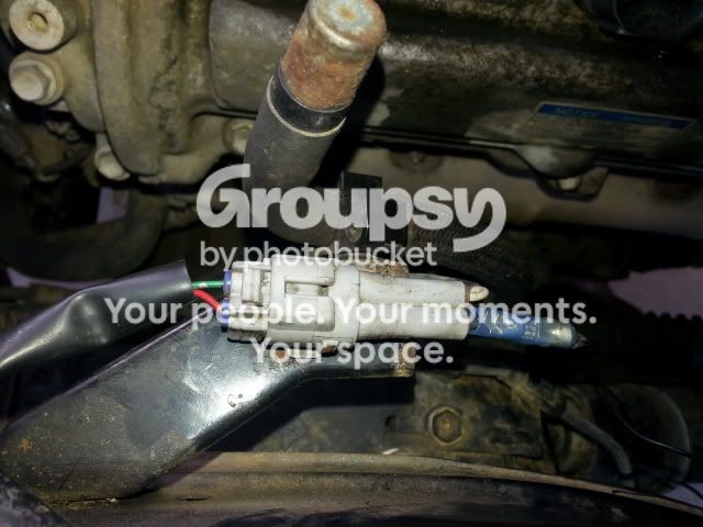

Hmm, the CV axle issue could be a problem. Can you post a picture of where you guys spliced the wire in at? I wonder if maybe there's a loose pin in the connectors and/or a kink in the original wiring that when bent and/or stretched is causing a loss of signal? Similar to work hardened wiring in door hinge areas, if you're familar with that. Perhaps a wire was broken internally, while the insulation was left intact?
Can you see on the scantool if the LF sensor is cutting out or not? (I'm sorry I mis read the original post, it's more likely related to the LF area rather than the steering now that I read your statement over again.)
I got some pictures and a video of what it's doing. I'll try and get them uploaded here soon. There's a chance it's not liking the wire we spliced in or that the short is right near the connector. But that wouldn't make sense to me with how its gradually getting better. So if there's nothing on the CV that could possibly be causing interference with it not being torqued properly then it has to be the wire or possibly the ABS Module? I'll try and get it scanned by a friend tomorrow and see if it's cutting in or out. Anything specific I should be keeping a look out for with all this said?
