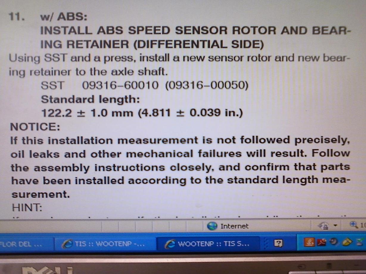

taken straight from toyotas service manual. I dont dont know how to copy and paste screen shots so i took the pic with my phone

Thanks, pauls4runner... I did find it right before I saw your post, actually. I've picked up my axle shaft now from the shop that's doing my gears & lockers, but the other shop was already closed when I got back over this way. They still haven't said for sure if they're fixing it gratis, but I will raise holy hell if they don't! :D

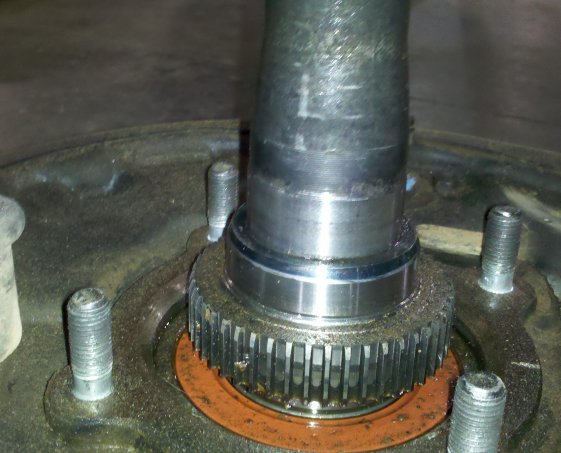

The guy definitely pressed it down too far. You can even see a mark on the shaft where the retainer used to live. Oh well...we'll see if the shop manager wants to admit his guy could've actually made a mistake.
Yup! it was definitely pushed in to far. It's a good thing you caught that now. I only figured it out after the axle oil came out all over my tires. The exciter ring has to move up about 3/4 inches up along with the second ring.
