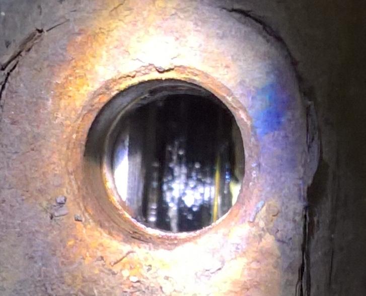

Unfortunately I was correct. As I came home tonight I felt like messing with it, so I took the wheel off, removed the sensor and tried to look in the hole with a focused flashlight... well I could easily see the ring is separated from the bearing and just rattles around. Not sure you can see it on the photo but it's pretty hard to take a good picture through that tiny hole.
So now I am likely looking at getting a new hub assembly, I doubt this can be repaired? I'll call the shop tomorrow but it's been at least 10K miles since they did the work so I doubt they would be willing to do anything about it.

I had this issue at one point too due to a defective hub/bearing assembly. I had installed it myself, and had followed the proper procedure, didn't notice anything unusual, etc. during install. New hub/bearing assembly cleared it right up though. Also gave me an opportunity to replace the inner hub seal, which I hadn't done the first time around.
You can get the hub/bearing pre-assembled from one of the guys on the forum, I'd recommend going that route if you plan to DIY. Good luck.
