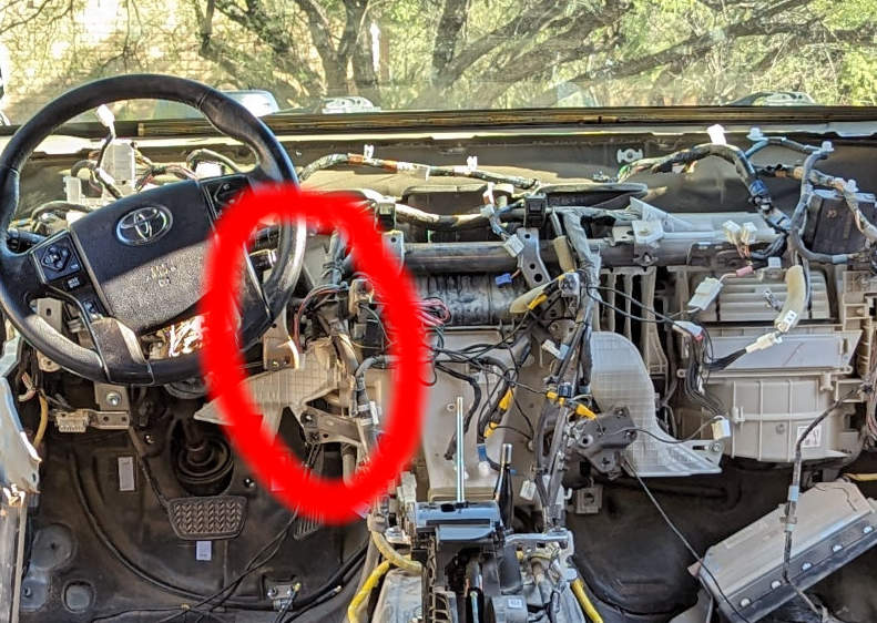

$2400 to replace a $100 part is always galling but doesn't sound absolutely insane to me given the labor involved. I just disassembled nearly my entire interior, dash included, and I didn't get as far in as you'd need to in order to replace that part. I wouldn't say the job is difficult but getting it in pieces without damaging anything (knicks and scratches) could be. My rig is already pretty beat up so wasn't a factor for me. Removal and reinstallation probably took me about 20 hours but I did a lot of cleaning and re-running aftermarket wiring while I was in there. YMMV

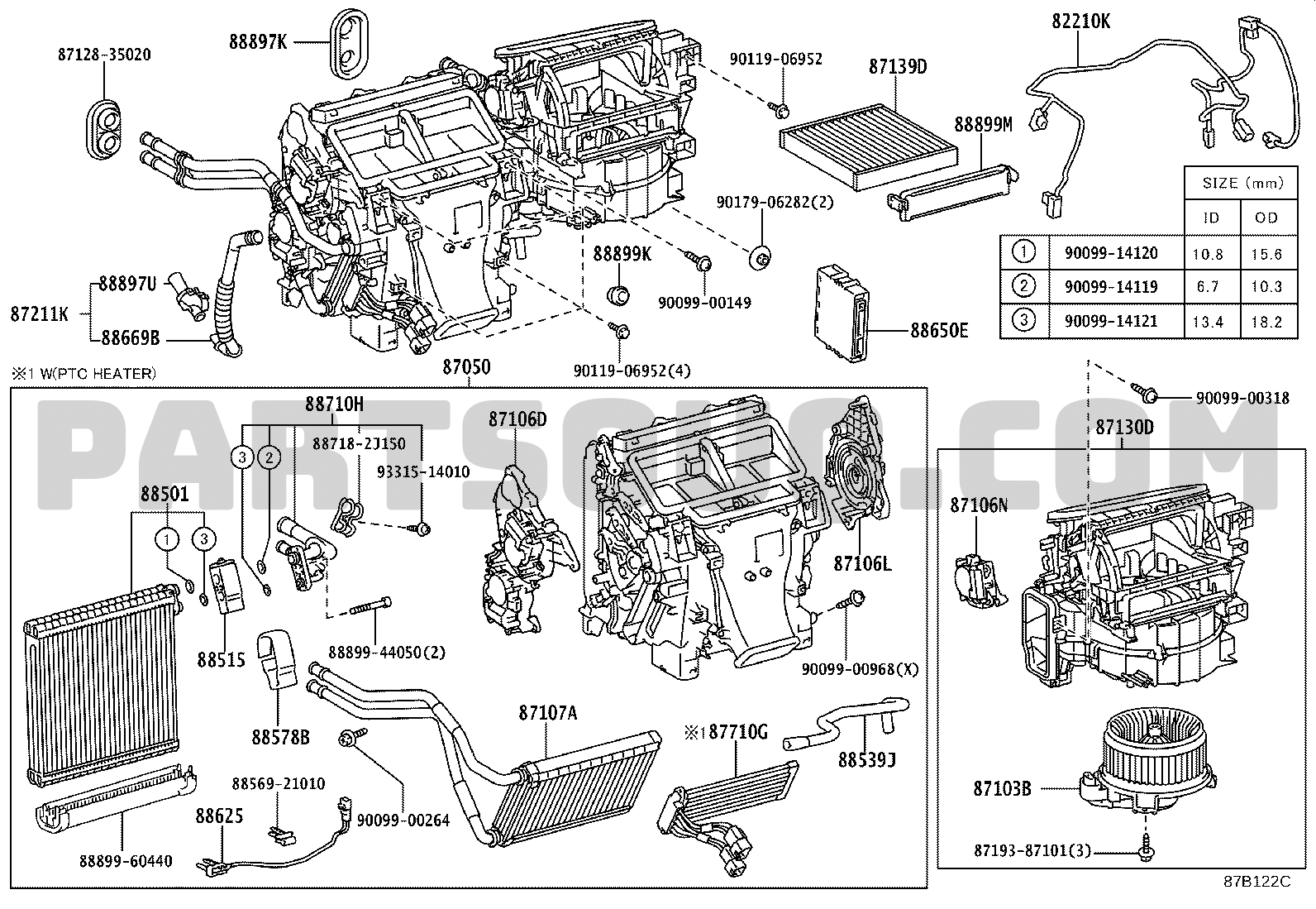

If only. I couldn't find the exact diagram but here's the part OP is looking to replace (87106). It is fully buried:
Pic from my rig with the area circled:

thanks guys! yea that last pic is about what I expected. removing dash pieces/steering wheels isnt a big deal. the issue for me is that it's ALL the dash pieces lol. we have the perfect opportunity this week to knock this project out.
