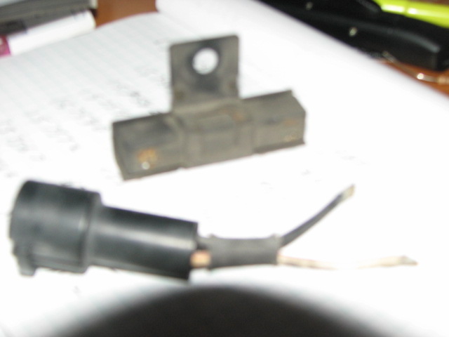

After futile searching. I have come to my 4runner brothers and sisters to obtain a part number (1991 4 runner 3.0 4wd 5speed.)the item is called a fan speed control resistor. It is located in front of the cooling condenser next to the Aux cooling fan. in this case the wire fell off and I can;t get an Ohm reading for the block.
On a separate note can we trick the system by putting some resistors in its place, and if so what size?

1.99 Repair
1991 4runner 3.0 4WD 5SP. The cooling fan for he AC condenser was not engaging properly causeing an increased engine temperature. The culptrit was the Fan resistor block- Part number 88635-89107. The local dealer wanted $46. A trip to the Pick A Part, amongst 6 retired 4runner's, showed that all have suffered from the same malady- detached wiring form the resistor block. My solution was a $ 1.99 0.5 Ohm 5 Watt resistor from the local Radio Shack. Placed the Resistor in the existing holding bracket, soldered the connecting pigtail.. Success the AC cooling fan engages.:guitar3:
