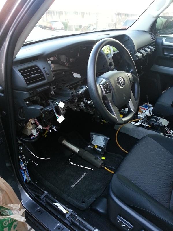

If it's going to cost you an arm and a leg to diagnose at the dealer, have you considered just taking apart the instrument cluster area and poke around behind there a bit on your own? There's LOTS of cable harnesses and things running behind there, so it really could be anything at this point; so if you have it all apart, you might be able to spot something that's loose and resonating when you accelerate...
If you are up for it, try downloading the factory service manuals in the sticky, the instructions are pretty straight forward to follow and it's actually not too hard to take it all apart (as long as you are patient) :)

Three service centers and $350 later, I was able to do a ride along with the mechanic and reproduced the sound at 22K PRM on the highway. They remedied by foam wrapping wire connectors that were tapping against a metal beam in the dash.
