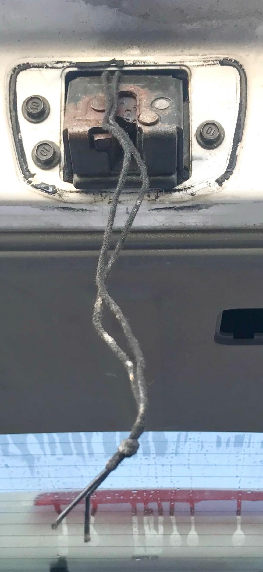

I have the dreaded rear hatch actuator failure. It was not staying closed. I sprayed a bunch of T-9 Boeshield in the mechanism and got one more day out of it until it froze up again.
When I pried the little cover off I saw what looked like insulation. I snagged with my knife and when I pulled it out it looked like a shoelace!!?!?!?
I yanked the shoelace a couple of times and it has worked perfectly ever since.
Is this factory????
I replaced my actuator and the new one had a shoelace attached as a manual release for the latch. I left it attached and tucked it inside the door.
Was it a piece of string or the plastic from the end of a shoe lace?
When I bought my '03 Sport it had a piece of plastic around the latch. The fixed part on the bottom of the tailgate opening. After a few years it fell of and the rear door began rattling. I have since cut a small piece of hose to replace them on all my trucks.
I keep trying to get the pic to work. It keeps going away, even though I put it up from a desktop. Is there a size limit for attachments? No matter what I do, I can't attach the Pic, I even shrunk it to 137 KB. Still didn't work. I could PM you the string pic, probably not worth it now.
